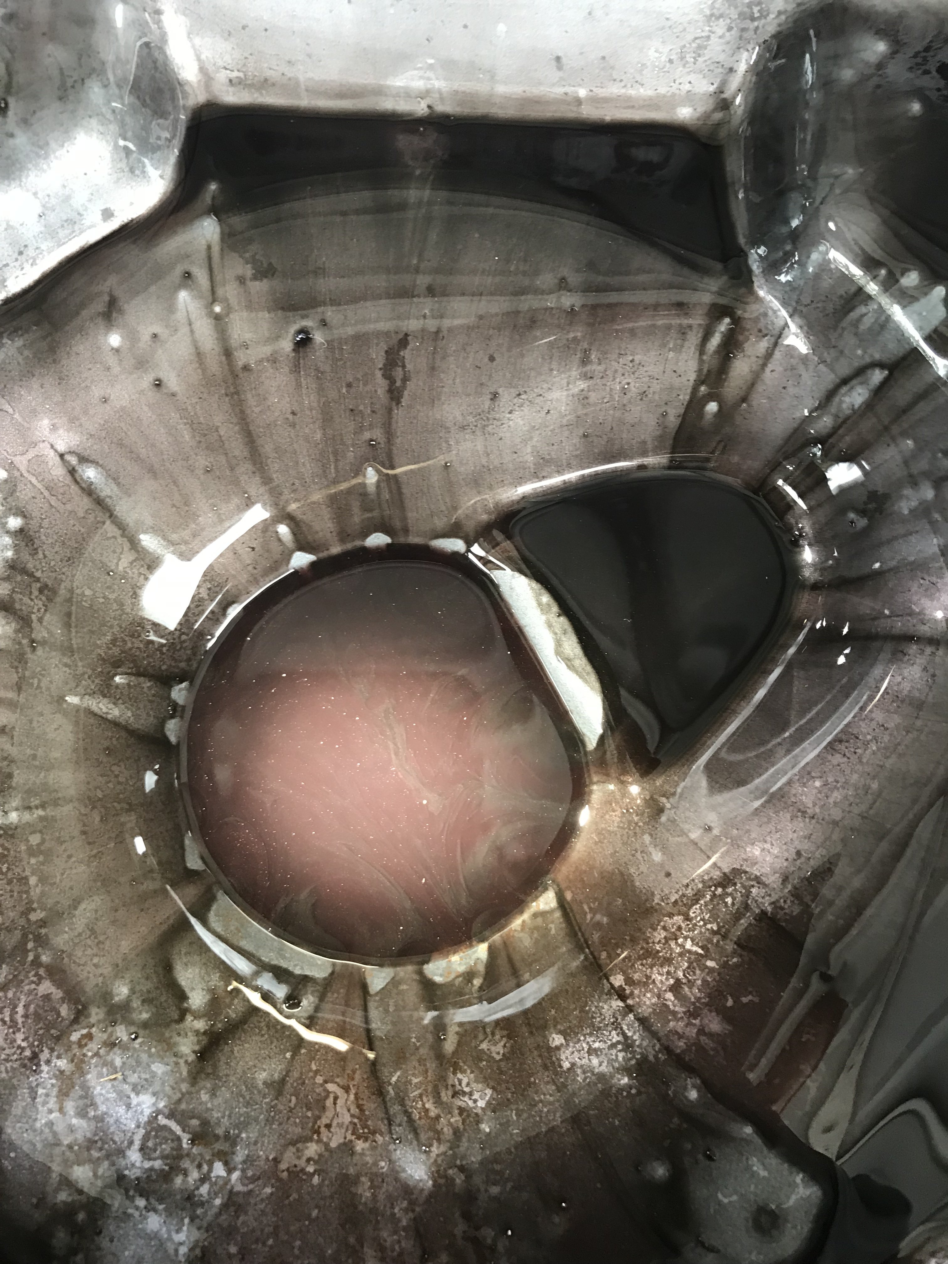

So I just took the pan off. They’re are some very light metal in it. Looks like a red metallic paint. But not bad I don’t think. Well. I mean I did just put new fluid in it and only drove it maybe 40 miles. Is this a bad sign of something? If I could upload a pic of it I would. I did order a new epc solenoid and valve body gasket set.
Nevermind. Here’s a pic

Your fluid does not look good for only 40 miles. Now you stated it worked on the jackstands but not on the ground. Consider when on jackstands there is no load on the wheels.
