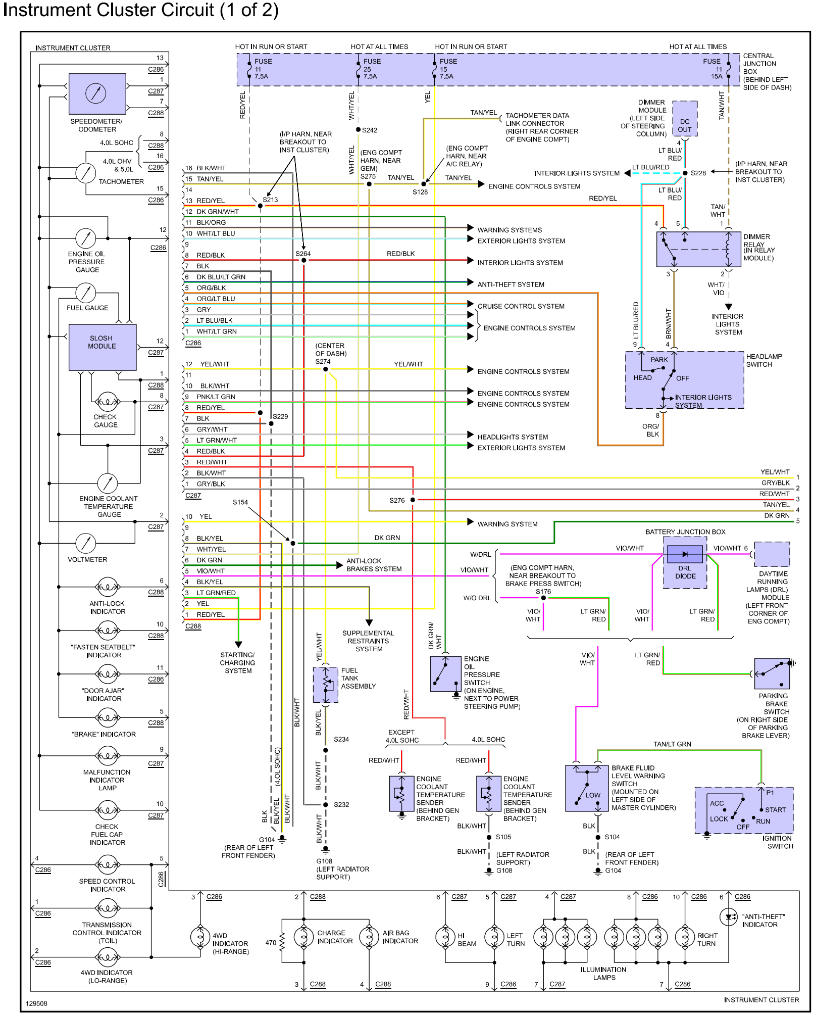

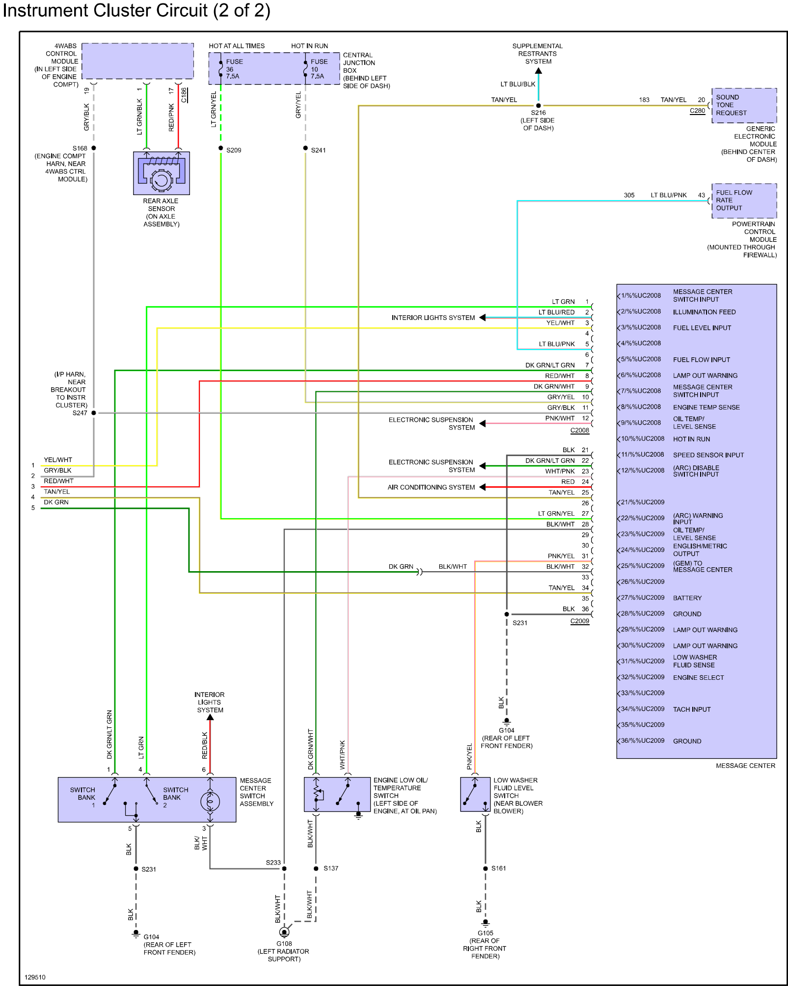

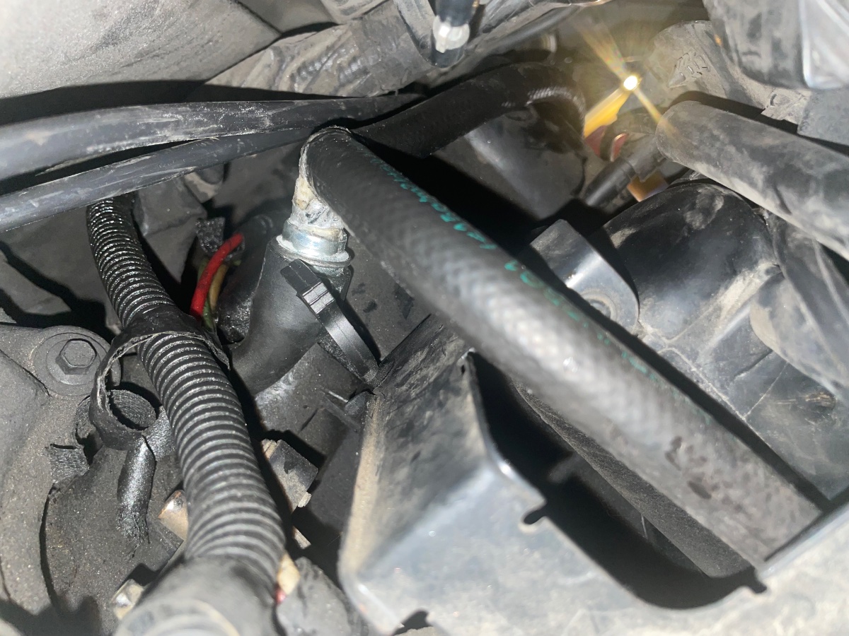

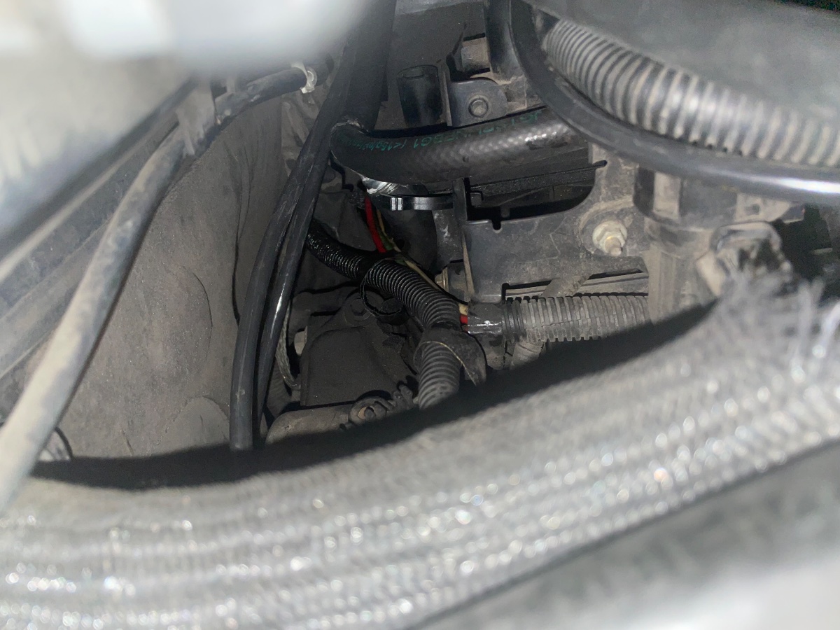

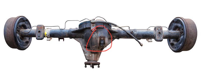

For the 97 you should have a speedometer cable going to a sensor port on the transmission. There should be a small exchangeable speedometer gear. make sure to order the correct one that matches your differentials gear ratio and tire size.I got it. Fix the codes. Find fix hiss. Pass smog !
Also I noticed the my speedometer has a habit of twitching or not working properly while running both fast and slow speeds.
