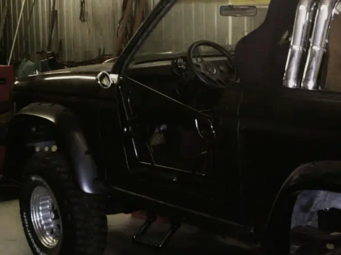

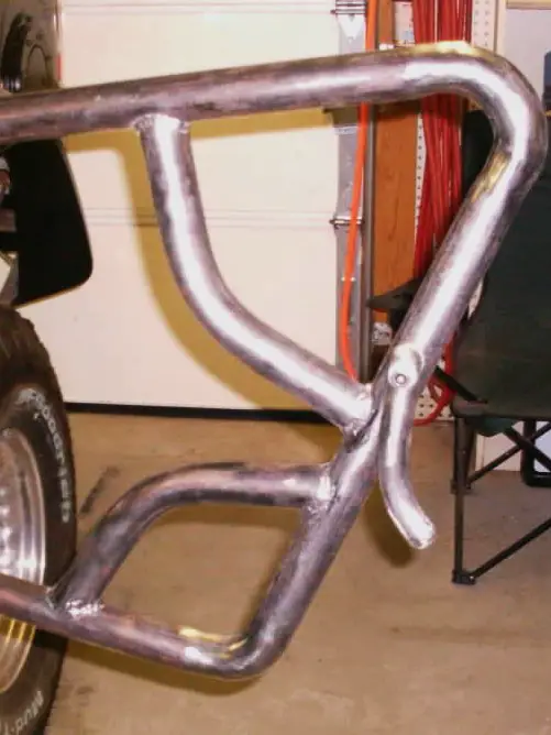

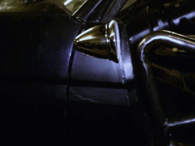

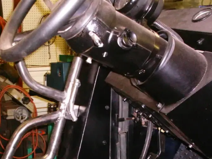

Raydot mirrors
Mounted the raydot mirrors and finished the handle and door latch.

yeah im a big fan of those doors. I think eliminate the leaf springs and all the probs that come with them and 4link it, for what you do it will ride better, you eliminate all the problems you were concerned about and its just flat cool, actually a radius arm might be a good option too, just riding on some kind of coil spring.
Hay ride
Thanks the tubes just need a little paint and I'll re-install the drivers side seat so I can take a few rides this week...wasting some beautiful weather sitting in the shop this Fall. Need to work on the tag holder, still plan on the "French" method framed into the tailgate.
Guess I'm a bit stubborn on ditching the leaf rear, but for now modifying it is my direction.
thats cool man i can understand that, sometimes you have things figured out for your own rig far beyond what you post online. im sure you have leaf spring ideas beyond what youve posted here

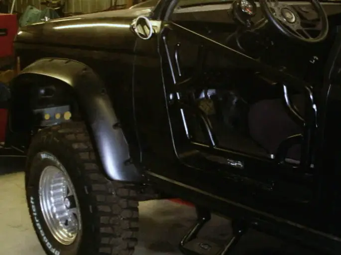

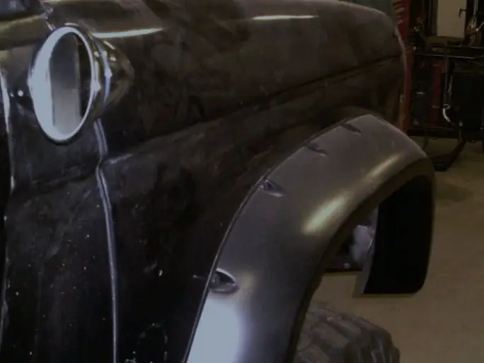

Few finish shots: Raydot mirrors are really small! Oh yeah got a seat bolted in so going on a run tonight...kinda want to respect the hunters and not do any early morning runs during deer season,lol.

WOW! Talk about giving your truck character. That is the Holy Grail of tubed doors.
What else have you got up your sleeve :popcorn:
Good point on not pissing off a bunch of Deer hunters first thing in the morning.
They could be worse then disgruntled Postal Workers, especially if someone had a big ole 10 pt in his crosshairs and then you...well you get the picture.
