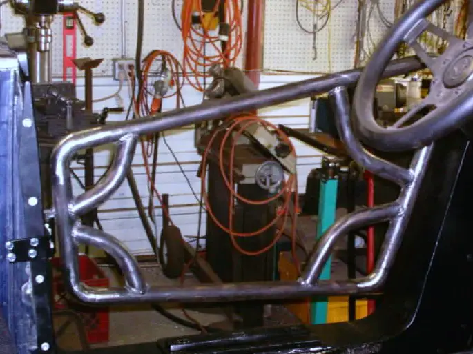

Worked on the drivers side suicide tube door today, was out of town yesterday so I'm already a day behind. Cut all the door tube and bent the tube gussets and notched them..trimmed everything and tacked the the frame and gussets in place. Ready for weld up tomorrow and need to fab another hinge bracket, clean every thing up and install. Like to get a workable door latch built & installed also, depends on customer work as usual it pays better and always comes first.

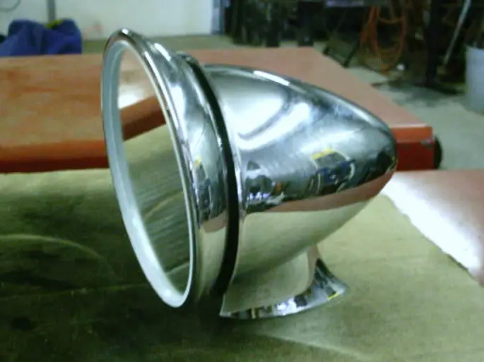

Found some racing mirrors that I had bought for a Shelby Mustang GT350, look a like, resto that I did for a customer several years back. The mirrors are reproductions and we found a pair of new OEM Raydots that we installed and I was left with the repros. Same mirror was used on the AC Cobras, well I'm thinking they might go on the Broncobra instead...won't hurt to give 'em a look see. Man they are really small and don't know if they are built well enough to take a pounding (the originals were super tough and you know that's true if you ever drove the real deal AC's or the 1965 or '66 Gt 350...they were hairy beasts of vehicles and would beat your kidneys into pudding on rough surfaces, so everything mounted to these cars had to be tough! Just have to find the perfect location to mount them. Bad thing is they are chrome, another bad thing is that when you are strapped into the harness you can't adjust a thing so the mirrors have to stay put or they are useless.

Drivers side tube door welded up but as yet unmounted, I did get the hinge completed and will need to pull the seat assembly in order to have enough room to install it. Door latch design still undecided...several to choose from, decisions, decisions!

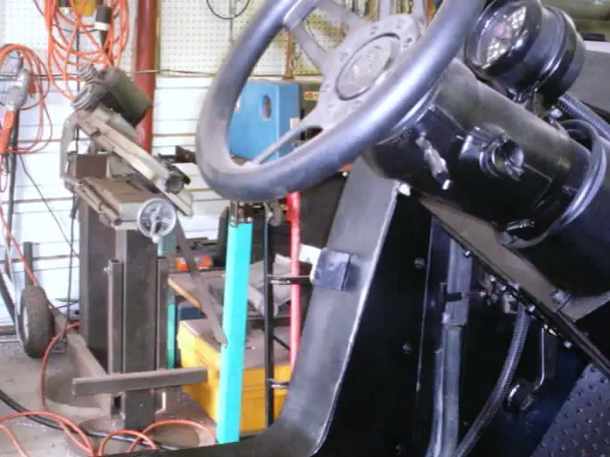

I picked a fine time to pull the drivers seat and tie up the Bronco for work that could have been put off for a nasty day. It has been beautiful here and the nights have been fantastic. I did get the Broncobra out early Monday morning for a couple of hours before daylight and had a blast watching the wildlife, mostly deer - but a lot of them...mainly on the roads!
Then I pulled the seat to install the drivers side hinge bracket and mounted the door. Fit up was good, so I built the door stops/latch brackets up front & was pleased with the way they turned out. They not only stop the door from turning inward but also securely locate the door and support it due to my wedge design. Plain speak... holds the door rock solid & will serve as the latching point when I locate a few parts to finish the latches up.

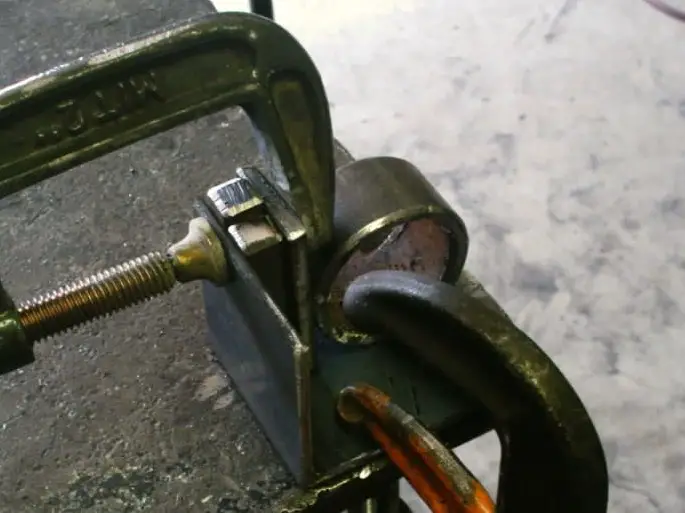

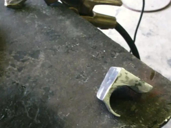

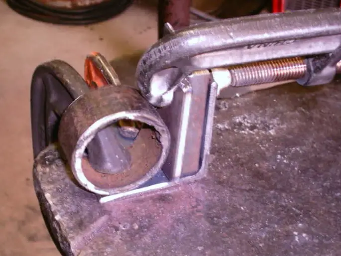

I took a few pictures of the latches as I decided to weld and grind the materials instead of just machining them. I have made a lot of small parts using this poor boy method and it can save you serious money with machine shops if tolerances aren't to critical for your purpose. With time and patience some really custom looking parts can be turned out in steel or aluminum, using basically scrap materials. I have mills and lathes, but many don't so I wanted to show the basics to those who have never tried to make anything but straight brackets out of angle iron or strap. The materials for the stop/latch body were as stated just scrap consisting of angle iron, steel tube, flat strap & 1/2" keystock (last 2 were just used as spacer/filler material). All of it was combined, jigged up and welded then ground down and shaped with a flap wheel on a 4" angle grinder & file.
Center photo is the bracket ready for polishing and painting, not quite as quick as a mill but the end result looks good and will work great. Obviously one could build several different parts that would serve the same purpose, I just chose to use what was laying around.

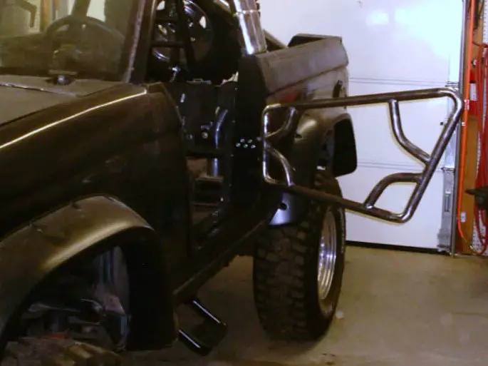

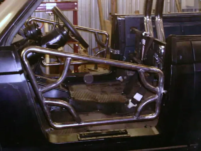

Tube doors mounted

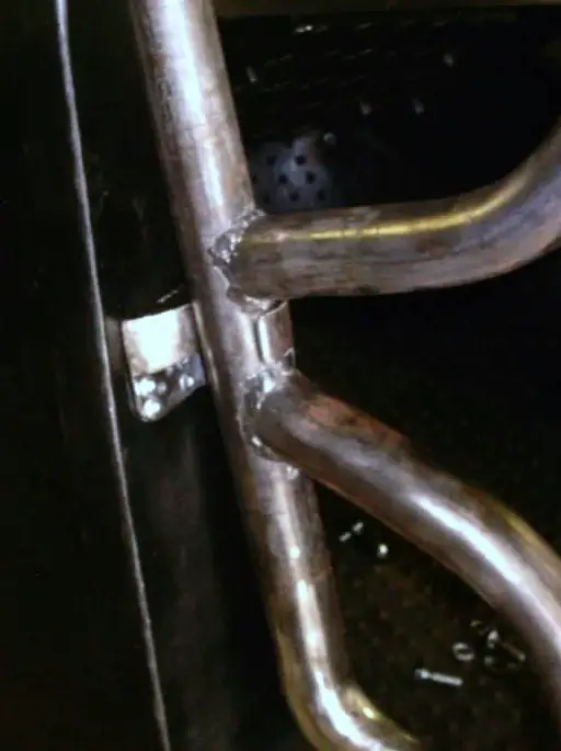

Tubes are mounted but I didn't have time to mount the latch stop brackets. Using the heavy door cap metal made the tube doors much easier to mount and structurally sound and once I've wheeled with them mounted for awhile I have the option to weld the latch and hinge to the cap for even greater strength, though I doubt it will be necessary.

Rookie you are ahead of me on the padding/insulation I was about to get burned with the tubes for sure!

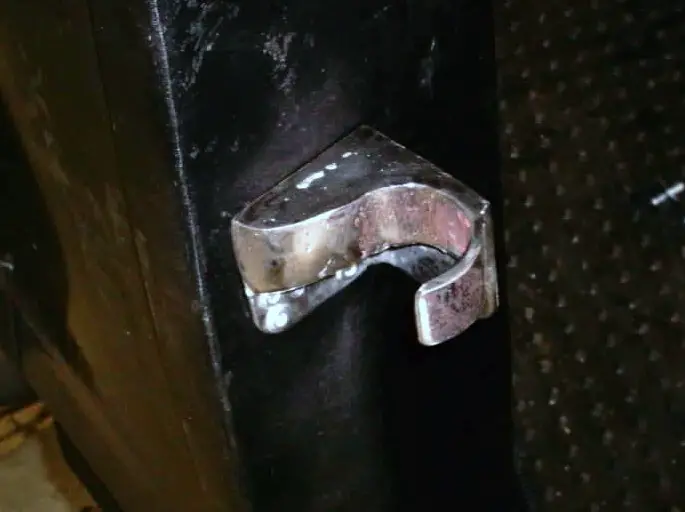

Tube door cradles/stop/suppor/latch body...whatever installed & really do work well. Raydot mirror shown, have a pair of these that I am considering for the Broncobra. After posting these pictures the simplest latch idea occurred to me, 30 minutes to completion and after this I promise not to post any more caps, latch, tubes or cradle information or photos again...ever!

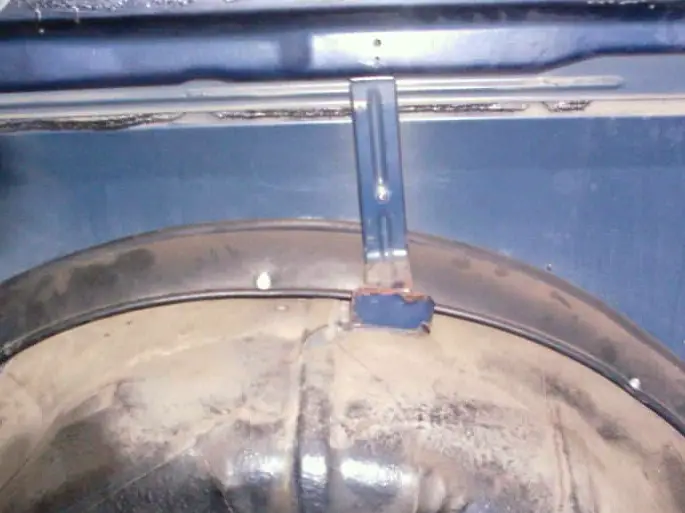

Photo shows a more asthetically pleasing and permanent resolution to my problem. I used a section of Flexy flare rubber that I had used before going to the cutouts, and contoured it to fit over the mess of sealant underneath & secured it with very short sheet metal screws. The sharp ends protruding into the wheel well were ground down and painted. The ground flat ends won't back out without the aid of a screw driver. Might not be the cheapest way to start with, but hey it looks good and I was about to trash 'em anyway.
