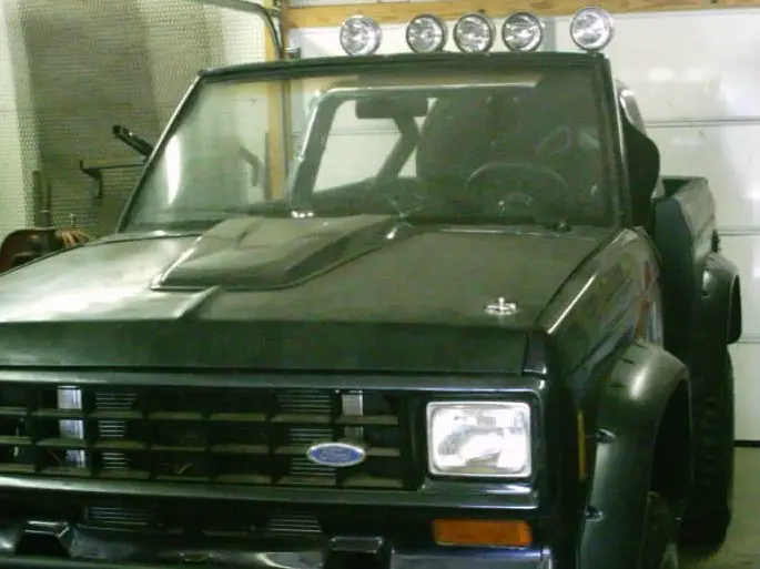

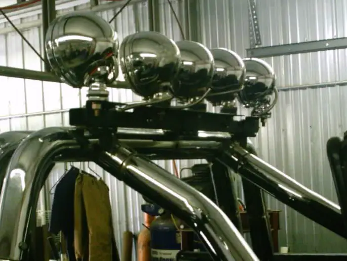

Got back on the construction of the passenger side door cap. Photos show the inside panel for the front and rear sheet metal as well as the step cap welded up and installed for a test fit. Also show the completed folding light bar installed with lights bolted up securly in the driving position.

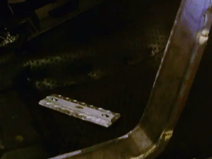

Detail

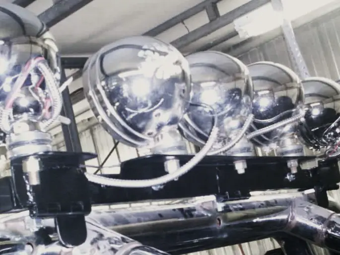

Bracket detail.
Shows the additional hinge welded in centered position, the tabs which stop the lights from being lowerd past horizontal and the bolts which extend from the support bar and are used to bolt the light in the upward or running position.
When I welded in the center hinge I placed a c clamp to hold it in place for welding, but after welding to the tube support bar I used an old welders trick to place the angle iron/hinge under tension, creating a spring. The hinge was left loose on the inside of the angle iron & the c clamp was clamped on the outside of the angle and the square tube thus slightly bowing the angle iron light support in an almost imperceptable arc. The hinge plate was then wedged up to it's position and then welded in as many places as could be reached while clamped and with a hot arc. Once released from the c clamp and hinged open the weld was finished on the exposed hinge.
The reason for this was to hold the light assembly up even when the safety bolts are not in place and tightened down. I realized on the test fit that if those lights, which have considerable weight fell from the upright position it was a certainty that some or all of the bulbs and lenses would be broken. The sping tension is considerable and would never allow the light to fall...enough force is required that I'm thinking a lever bar really is needed...so one more project, once the sping tension is defeated the lights are held by the same forces that I just described in the work light position...horizontal therefore no bolting is necessary in the down position. Those KC's stay right where they are adjusted to point- up or down!!!

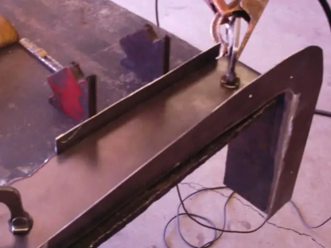

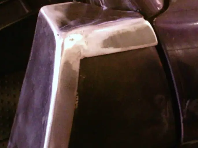

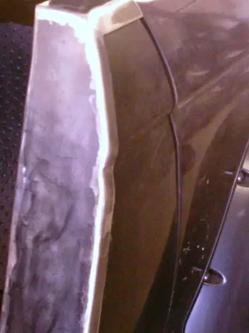

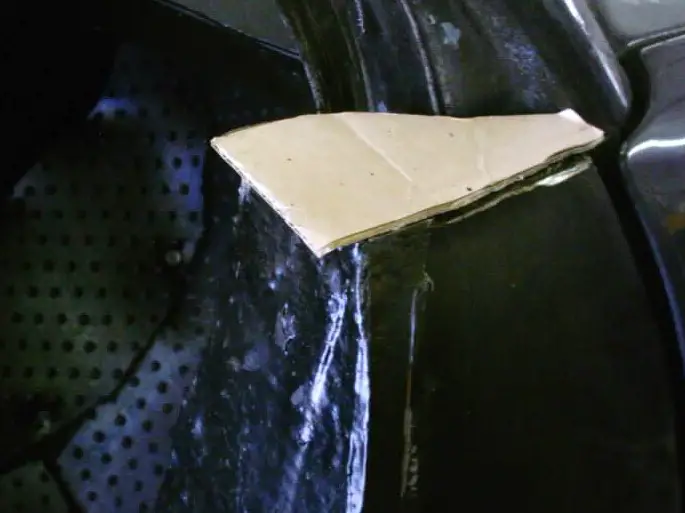

Almost finished with the passenger side cap. Cut two 1 1/4" trim pieces which will finish the outside edge of the door cap. Then welded to the rest of the cap in sections following the original door contours. Cardboad templates were used extensively for patterns, shown is a tiny one to trim out the A pillar cap. Several test fits to make sure the 2 sections of cap would still fit over the door skins after each little section of the 1 1/4" trim was tack welded to the main body of the cap. I also waited until the final tst fit to trim the two sections of cap in the middle. Built the passenger side in about a third of the time it took to build the drivers side. Something to do with learning curve I believe. Curved section of trim was cut and fitted last of all. When it all fit I finish welded the inside edges first and with as little heat as possible to avoid distortion, then after another test fit outside edges last and again low heat to the tip & fast travel with small diameter wire. Finish up with grinder rounding off the outside edges and smoothed with a sanding disk. Final cleanup and washdown with solvent...ready for paint inside and out. Fit is very snug and sheet metal screws attach inside metal cap panel to interior truck panels only. Final touch is to mount the diamond plate step plate to match the drivers side with pop rivets. Next I'll put a longer piece of diamond plate on the cap of the tailgate cutout to match the door step plates.

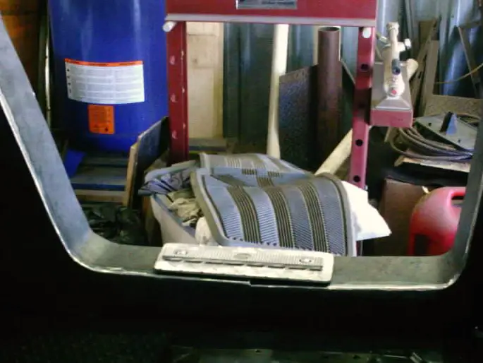

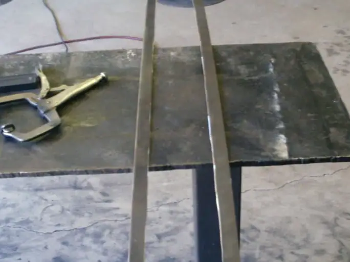

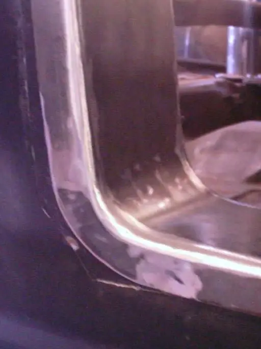

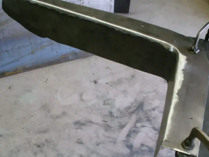

Door caps are ready for paint....finally, and took some shots on the final, final fitup cause when they are painted black they loose contrast with every other thing which is black.

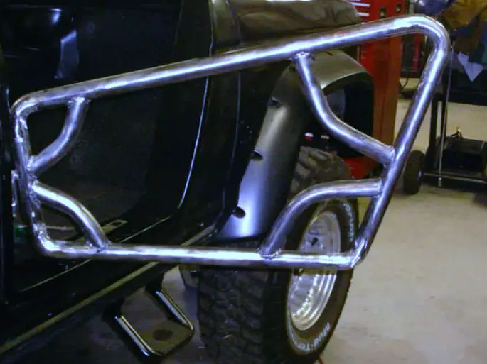

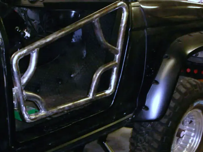

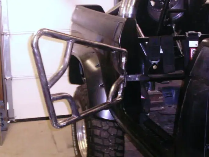

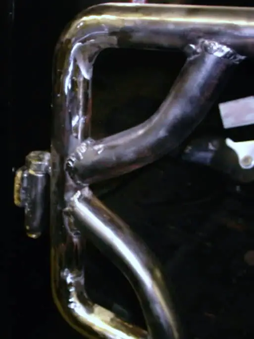

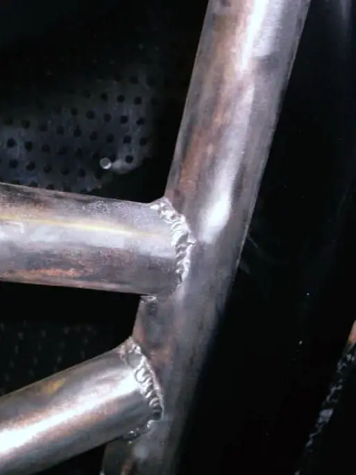

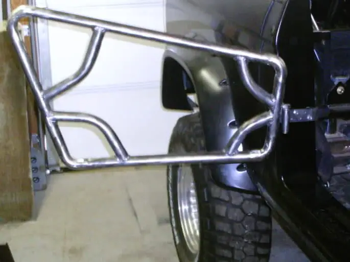

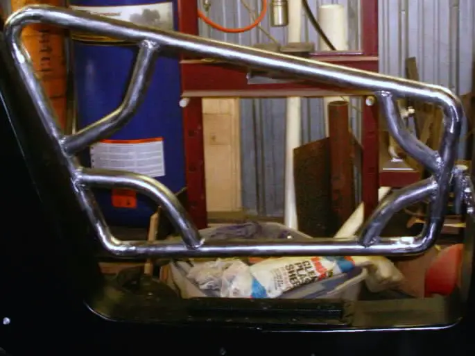

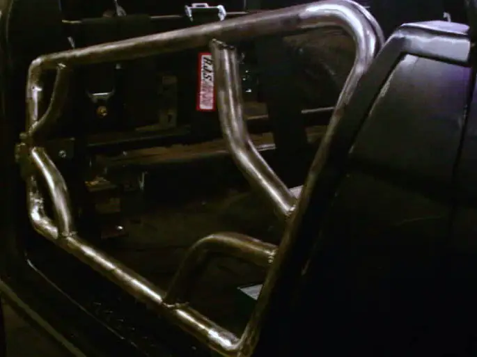

DOM tubing back ordered....:salute:so Imarched right into it with some 1-1/2" inch mild steel I had on hand. Really started as a prototype exercise to amuse me, but it turned out that I kinda like it. I had the seat and bracket out on the passenger side already so I worked on that opening first. Since the bends weren't radical I used some pre-bent pipe and the rest were done in a pipe bender since my Huth was being used for a customer job. Bent the support bracket from 2"x3/16" steel in a heavy duty bracket brake. The pivoy was made from a grade 8- 9/16" bolt swinging on a 5/8" ID pipe welded to the 3/16" strap bracket. Still have quite a bit to finish as far as additional support for the hinge and haven't even started on the forward latch. Rat fink special for sure!

Thanks Jon finish this one & start on the drivers side...fun, fun!
