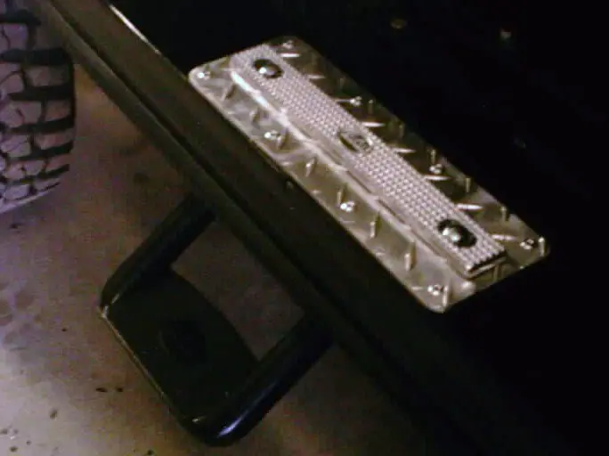

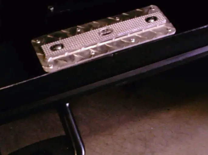

1. Passenger side door cap...completed
2. Step plates for the door caps and the tailgate....completed

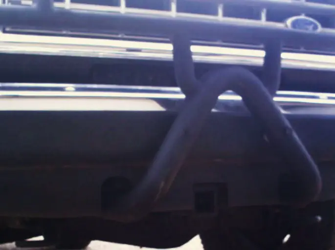

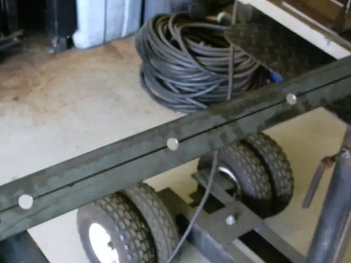

Deep subject that you pull water from...oh well. Interesting day that included a lot of customer work of the not profitable or interesting type, but good for public relations. Finally got to work a little on my stuff. Finished the scuff plates/ door sill/ door cap, not sure what to call it. Used pop rivits to attach.

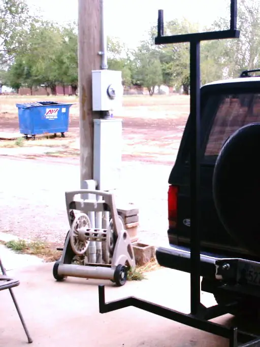

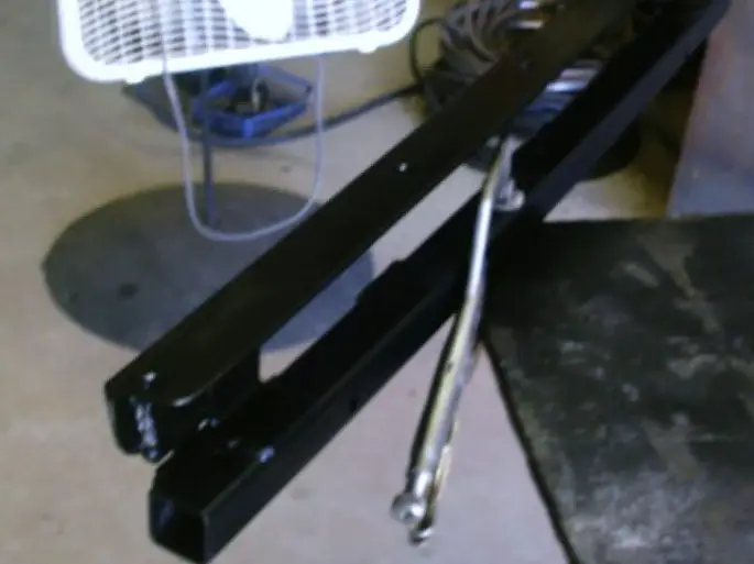

Rookieshooter has a neat little tool that he hooked up to his winch hmmm, got me thinking. My DD has receiver hitches on front and rear, that I use for all kinds of tool attachments that I have made one of the ones I find myself using frequently is a rack that I plug in front and rear to haul 22' long steel and since I have a roof rack that I don't trust to carry much of anything I don't want to fall off on the road, I can at least use it as tie downs and if the long limber pieces of metal flex the factory roof rack protects the top from dents. Sometimes I just mount the one shown on the rear to haul metal walk gates (I also bend ornamental steel) rather than hook up a trailer....just lash it on. I also have attachments that I can bolt on to support odd sizes or irregular shapes.
I never even thought about using these tools with a winch, but I bet one could easily build an adapter that would accept both winch and tool into the appropriate existing receiver hitch.

Daily driver
Didn't take the time to plug a rack into the front receiver but I doubt anyone will have a problem seeing the utility that such a setup serves. The tools might be as large and robust as is required the small carrier shown on the rear of my B2 is duplicated without the gate carrier on the bottom and allows long loads to be safely carried...the 1 1/4" tube that was used for the frame has carried as many as 20, 22 foot long pieces of 14 gauge steel 1&1/2" tube...want to carry more just build using heavier material and appropriate gusseting. Imagination is key to building something that you can use. Simple or elaborate, up to the individual, safety, utility, functionality and servicability ...some of the things i'm interested in when designing tools.

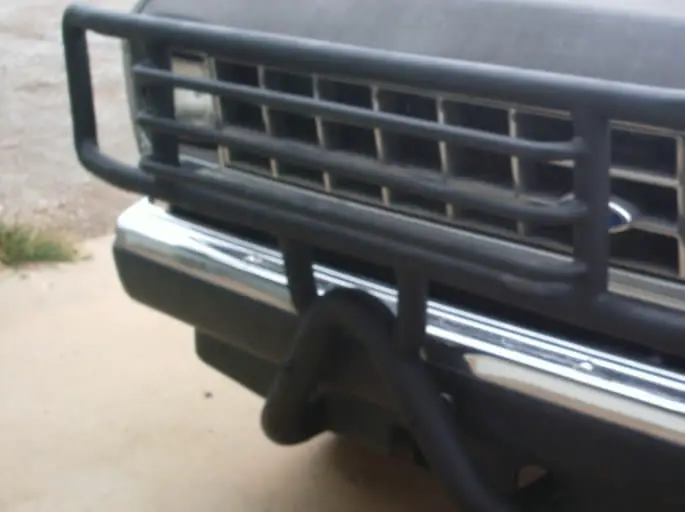

Brush guard is welded to a half inch thick 3"x5" angle iron bolted to each frame with grade 8 -5/8"inch bolts, the plate is used as an attaching support for not only the guard but also towing hooks and the receiver. The plate also substantially strengthens and stiffens the frame.

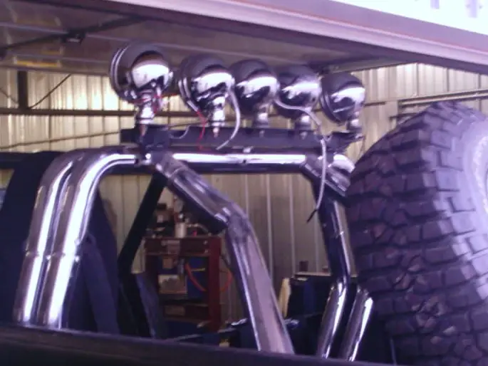

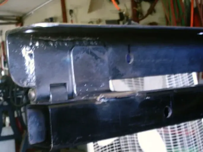

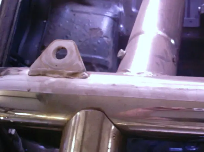

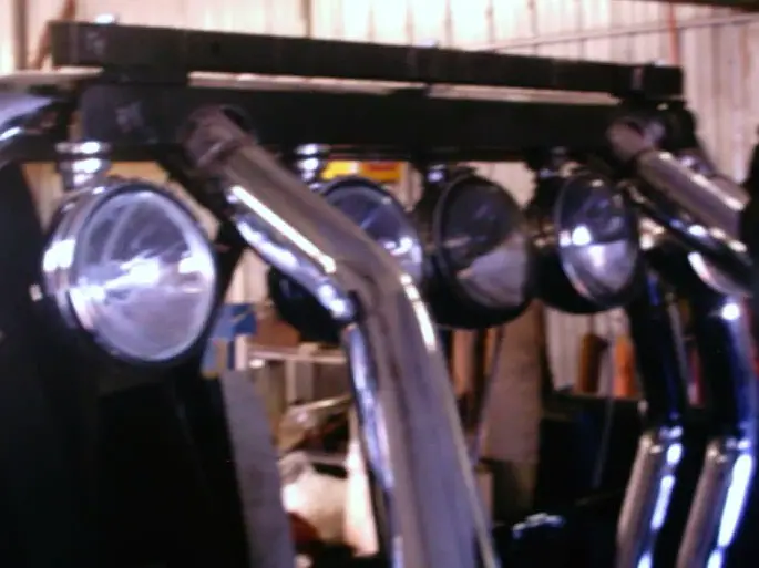

Light bar
Took the Light bar off in order to convert it to a fold down bar utilizing three 3inch weld on hinges & a 36" long 2" angle iron with 5 - 9/16" holes to mount the 5 KC Hilites on...the hinges will be welded to the 2"x2" tube after the 5 existing light tabs are cut off. When the lights are lowered I will gain 5 inches of head space going into my garage, which will be necessary after the upcoming suspension changes.
When lowered the lights will shine directly to the rear providing the potential of a 1,000,000 candle power work light.
The photo shows the 3" diameter down brace for the double bars...need to increase the distance between the lights to clear the fold down.
The tabs on the original bar will all be cut off & 3 hinges welded to that bar.

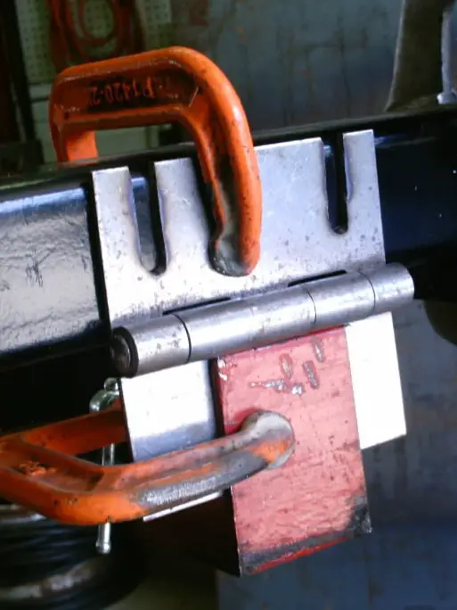

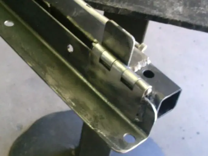

Fold down light bar
Hinges were not in stock locally so went ahead and drilled the angle iron for the light mounts and cut off the old tabs....dummied up an old hinge and scrap 2 inch angle iron to make sure my mental image was correct in fact. Glad I did as it gave me a way to see a couple of things that I would need to do regarding pinning the light in a verticle position when lowered (kinda need the lights to shine straight back and not canted up as they will do because of the weight of the lights & for securing in the driving light, up, position.
Shows the angle iron light support
Hinge down light directed straight back
Really a simple solution & eliminates the need to add extra work lights to the rear of the truck...which unless caged in steel will quickly be broken, usually by me. lol

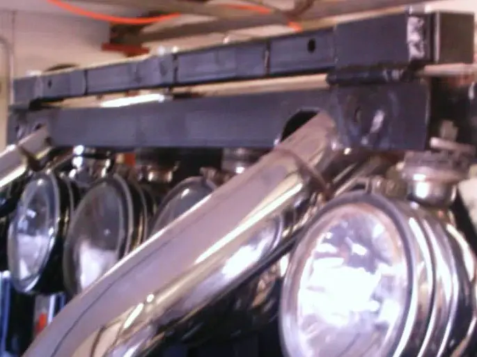

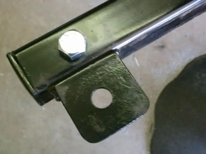

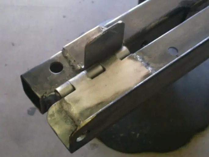

Metal work is complete on the light bar, waiting for paint to dry...probably mount it latter this afternoon. Took a few shots while I was working:
Painted photo position lights would be in the down or work light position
The second photo shows the bar in the running light position, bolted firm
The bracket tabs come to bear on the light bar angle iron when in the down position (pointing towards the trucks rear) & prevent the bar from swiveling the lights past horizontal.
Final shot bar is positioned between the up and down positions
The square tube will be bolted to the roll bar and the 5 KC Hilites will be mounted to the angle iron.
The holes closest to the hinge (both in the square tube and the angle iron) are located on both ens of the assembly and are for the 2 bolts which will secure the light bar in the running position.
Most of this will be readily apparent when I post the whole light assembly photos.

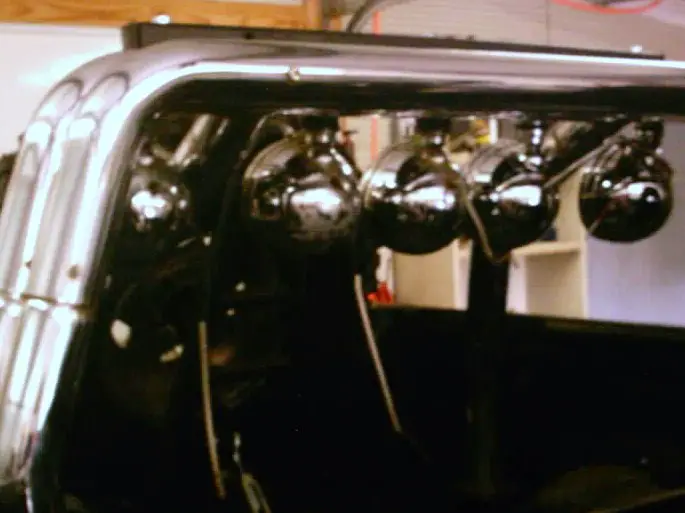

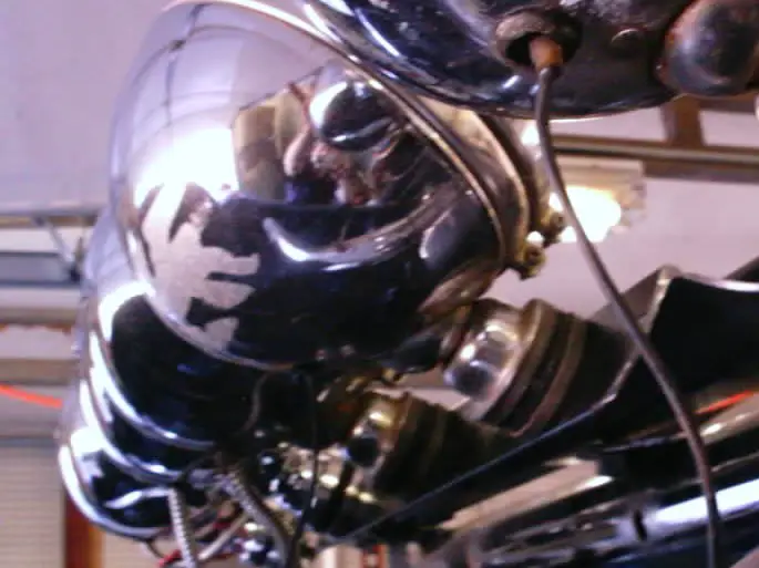

Fold down light bar/work light
Mounted lights to check fit and everything clears still have to paint and wire up. I will use the two out side lamps for work lights, as I have switches and relays to run a combination of either or both pairs or a single (middle of the 5) so I'll hook up outsides as a pair, insides as a pair and center as a single. Three switches total, fused and on relays.

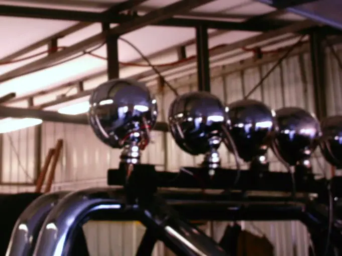

Light bar continued
Think photos are self explanatory, lotta light for front or rear. lol

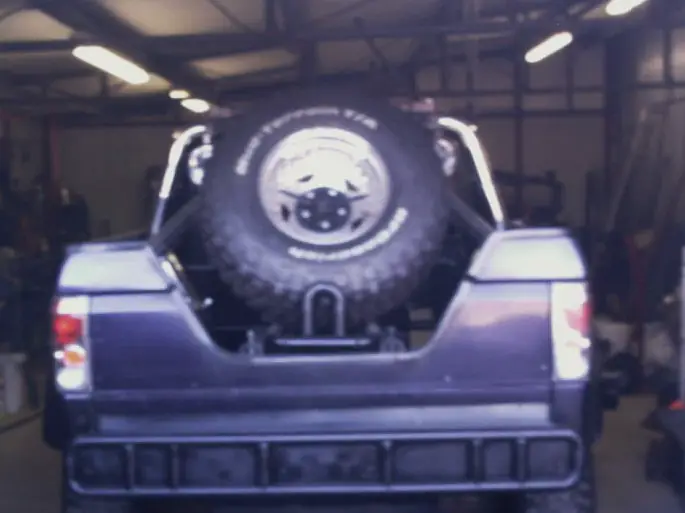

lights & mods
Rookieshooter is always an encouagement.

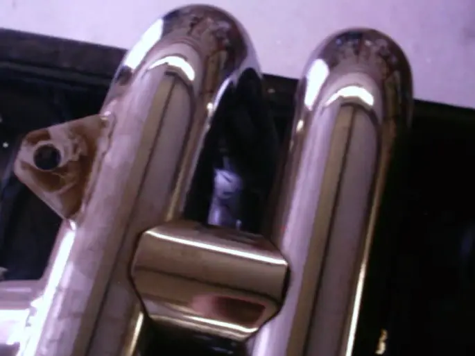

Light bar, roll bars, tire carrier & both seats will have to come out yet another time during fabrication of frame support crossmembers for chassis strength and a solid platform on which to mount roll bars and the shock cage.
A large section of the rear floor pan will also feel the heat of plama, as I clear the way for my rear suspension workover. I am trying to occupy my time with making the small changes that I have been putting off, like the light bar and door capping (which I will get back to shortly) & other odds and ends. Weather here is quite nice, still bone dry, but I want to keep the Broncobra in running condition until Winter so I can have a little driving fun, yet make some progress on her build.
Light bar would have been so quick and simple to construct except for the rear extending support legs of the roll bars. They are 3" in diameter and in the way of the big KC's necessitating a wider spacing between the outside lights than those in the interior. Not only that but they also interfere with the angle iron light support bar when the lights are folded to the down and shining back position, making the lights shine up into air traffic space. lol
As you may have noticed a quarter moon shape cut into the angle iron allows them to fold all the way down, but this cut substantially weakens the very bar that is the sole support of the KC's and would certainly fail in even moderate offroad environs. I will add a third hinge in the center which will substantially strengthen the bar & also add small gussets to reinforce. That's why my crappy photos show areas that aren't painted. Just a test fit. I really don't mind the extra fuss with the lights etc. as problems create opportunities to make a vehicle special and even when no one else knows what we go through in getting our poor little projects completed...we do.

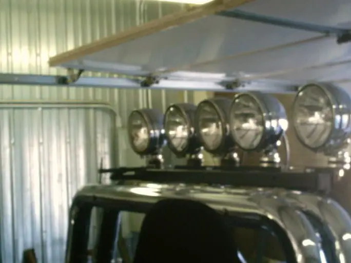

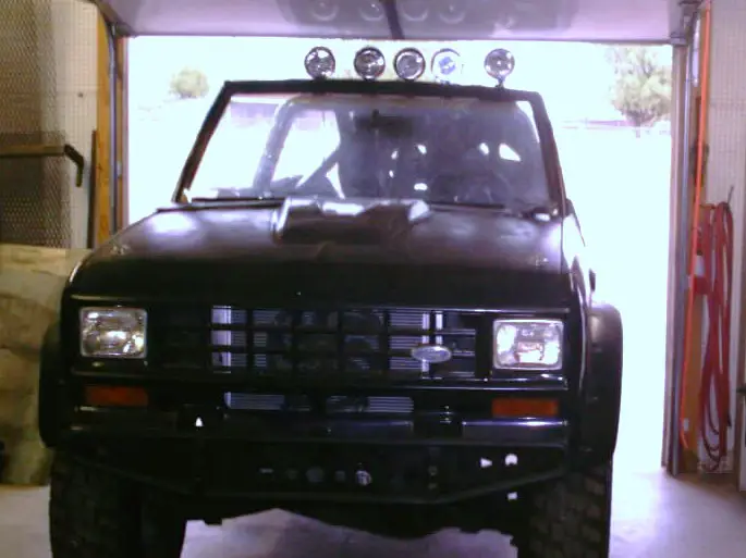

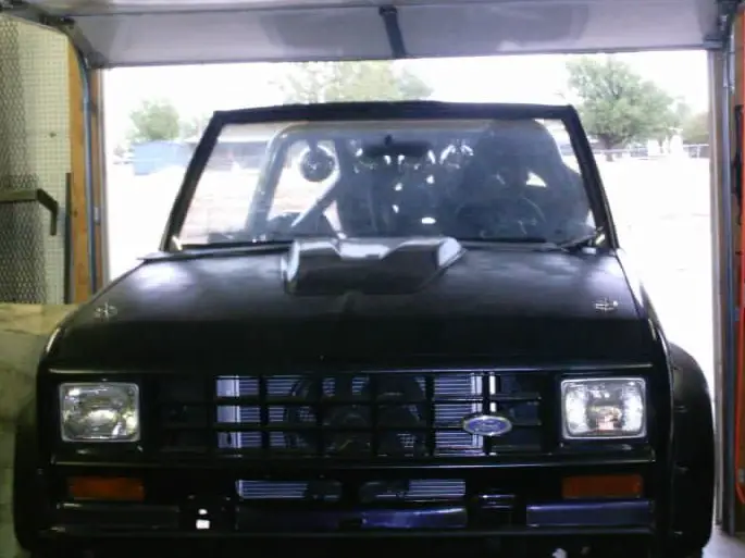

Overhead door
Just had to see the difference in clearence on my overhead shop doors. The photos don't really reflect the one inch I had to spare with the KC's up, but they do show the big difference when the lights are lowered. Pretty happy with the mod. Also painted the polished aluminum door cap plate.
Also welded a center hinge on the bar for extra support & attached two bolts to support the lights wile in the upright position. The light bar will also be used for attaching the Bikini Top.
