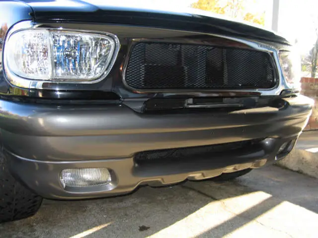

Well here are the finished pictures. It's been raining here so its wet and a little dirty. I like the black mesh but at a distance you cant see it, only up close. All you see is a big hole. I'm undecided if I should leave the grill black or paint the grill aluminum color, which would stand out alot more. What do you guys think?
Grill Finished and installed:
black for sure
or dark grey
Black definitely, but not flat black. It should be as close to the rest of the body as possible.
I like black. I would hit up everything behind the grill with a coat of flat black so you don't notice it. How does the logo look on the grill, have you tried it or given it any more thought?
