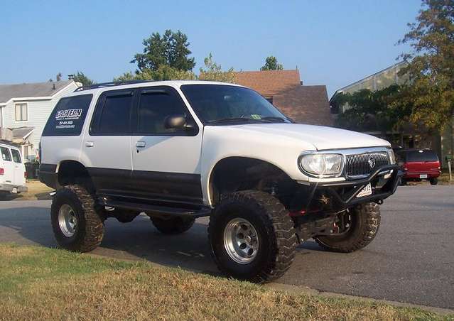

I just noticed , in the front shot, the angle matches the angle of the Mounty grill perfectly---very nice touch, like it was planned

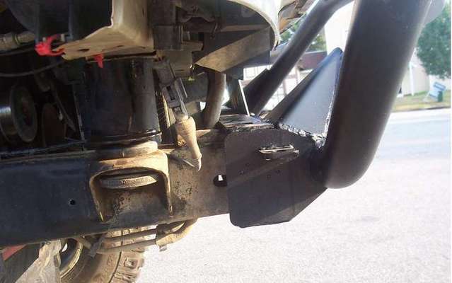

Ok I found this bumper to work great in my situation. You need a 3" bodylift for it to fit perfect. Its a prerunner style bumper made for a TJ / YJ. I cut the front horns off the frame along with about 2"-3" of frame. This bumper fits on the end of the rails snug. The only thing holding it on at this second is its welded on to the frame at the bottom. I plan on attaching it bry drilling a 5/8 hole though the bottom of the bumper, through the frame then though the top then intalling a grade 8 5/8 bolt on each side. It has 4 light tabs and 2 mounts for D-rings. I picked it up for around 300$ but I am not sure of the brand. I love the improved clearance and look of it.
I seen that bumper for sale before, but I can't find one now. Summit had them http://store.summitracing.com/partdetail.asp?part=smt-76611 , but now it says they are not available. Where did you get yours? I should have bought it when I saw it. I like the way it looks on your truck, guess now I'll just have to bend up my own.
looking at the pictures again, it almost looks like it would work without a body lift or maybe just a 2"

looks to me like you would have to trim the grill a little if there was no body lift
It wouldn't fit the body as tight but you could just extend the frame a few inchs to get one on without a body lift at all.
You would only have to take the bumper mounts off and not cut any of the frame off just to keep it spaced out. Basically 2"-3" forward. I don't think it will look too hot without a body lift but to each his own.
what are you going to do to hide all the ugly stuff you can easily see now that the bumper is not hiding it such as lift blocks and like where the front fender stops? just curious if you havemore plans for it. i must admit that was a pretty amazing idea you had to even try it .

he could make some gap guards out of that pond linning stuff....BTW Booming the bumper looks great
Well when funds become availible a winch is going to be where my lisence plate is followed by a skid plate right below it. Since I took the pics I have painted everything black behind there and added a set of lights which hides it pretty good. WhenI make fenderwells I'll probibly extend them into the front area some to cover the gap.
that bumper looks sweet, the lift looks good too. i'll have to swing by eta some time and see it in person.
