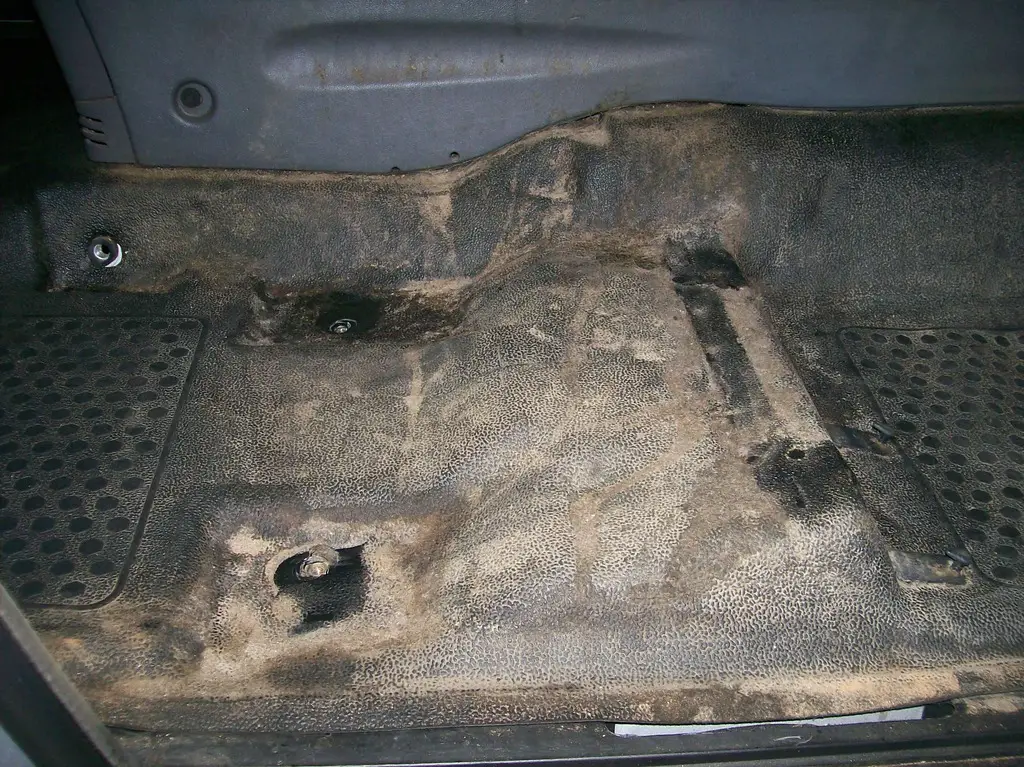

The passenger seat, door sill trim and kick panel trim are off and I did a cursory vacuuming, but the passenger side floor is even more disgusting than the driver's side. I think there must be a whole dead dog under the console and before he died he puked all under the seat. Another rubber glove day. With any luck I should have the right side body bushings in by tomorrow.

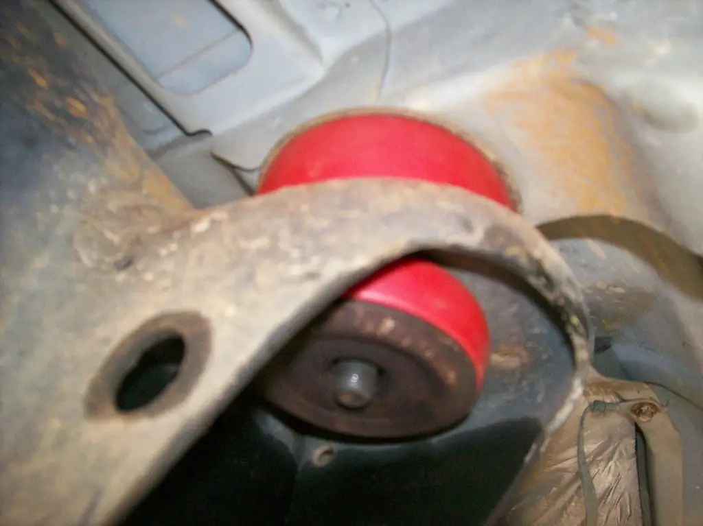

Okay, got the passenger side "A", "B", and "C" body mount bushing installed this morning. It didn't take as long to do as the driver's side, partially due to the learning curve and partially because there wasn't a parking brake cable in the way.
I decided to torque the mounting bolts to the recommended OE spec of 59 FP's on the "B "& "C" mounting bolts and I tried to use the spec of 41 FP's on the "A" mount. I don't know, but I think these torques are too much. The "B" & "C" bushings are bulged out quite a bit, I guess they're okay, but I wouldn't tighten a suspension related bushing to that extent. I tried to torque the "A" bolt to the recommended 41 FP's and washer under the bottom mount starts to deform and the bushing was really bulged out, so I backed it off until it was only starting to bulge a little. Then there's the nut on top of the "A" mount, which can easily be torqued to 41 FP's.

Now I need to start cleaning the passenger side floor, console side and seat... maybe later, maybe tomorrow.
Below are some pics of the way the bushings look so you can see what I'm talking about. What do you think? (Pic order is "C", "B", "A").
Looks good koda. Must say I was very surprised hearing this from Todd Z. 20 ft/lbs. tighter than spec? :eek:
IDK, I took it for a 30 mile test drive. It feels much more supple with the new mounts. I can even tell that the body is slightly higher than it was. I hear a little clunking while driving over my bumpy 1/4 mile driveway. Sounded like it was coming from the front, so maybe I should tighten the "A" bolts more. Once I was out on the roads, I heard nothing and it felt really good. No more jarring over pot holes.
I read the link you provided. I guess the bushings need to be really tight. I just don't see how I can get the "A" mounts to 41 FP's w/out bending up the rather thin bottom washer, but at least that ones the easiest to get at. I'll see what Prothane says next week. IDK if the specified torque is to pull the 2 halves of the mount together until they stop, or to just squish the bushings. I'll try tightening the "A" bolt some more and see if the noise goes away.

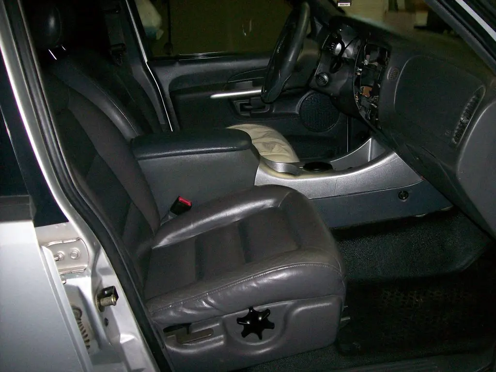

Clean floor, console, seat and back together.
