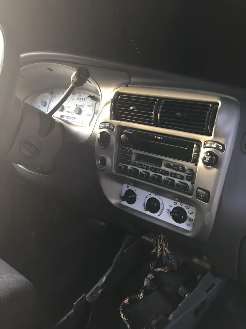

Cool. Post the pic of it in the daylight and I'll check it out. How does it attach? Does it just stick on?
I have a spare set of black HVAC controls. I wonder how they would look. Maybe better than the mismatched silver. White would be better though.
BTW, I was just looking on whitefacegauges.net and the picture the show under EXPLORER looks identical to your night-time pic. It also says it's for the ST. What didn't match on your first order? It shows a price of $13.99 so with shipping I suppose it would cost around $20. Reading the installation instructions show it sticks on.

http://www.whitegauges.net/categories/Ford/Explorer/ If you look at the ex heater control above- that's the one I got at 1st but on eBay. I didn't realize the difference till I about put it on. The dots supposed to be # the cold/hot was different and vent options off instead of a zero. During the day it wouldn't of looked bad but at night it wouldn't shine threw right. I was just going to stick it on at that time. Another member lead me to those gauges but when asked after the fact, he didn't have a problem with it at night cause he took the old off then installed. But either way, they look great-day or night!
For the price- I think it's a good cosmetic change, more for the driver than to show off but those little things bug me I guess

Thanks for the daytime pic. That really looks good. Matches the instrument cluster nicely, kinda ties everything together.
