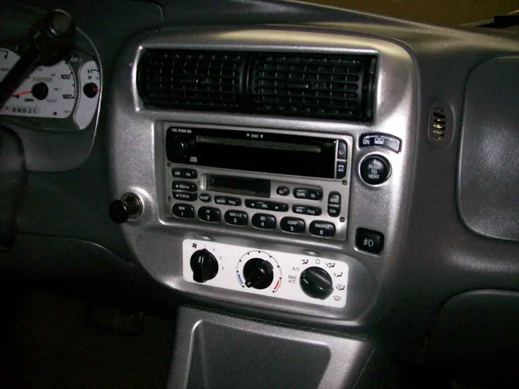

I received my white-face HVAC controls overlay in the mail this afternoon. I think it looks good. Thanks for the tip kj.
Before white-face:
After white-face:

Now that looks clean! Honestly w/ the newly painted bezel that old hvac overlay was a sore thumb.
