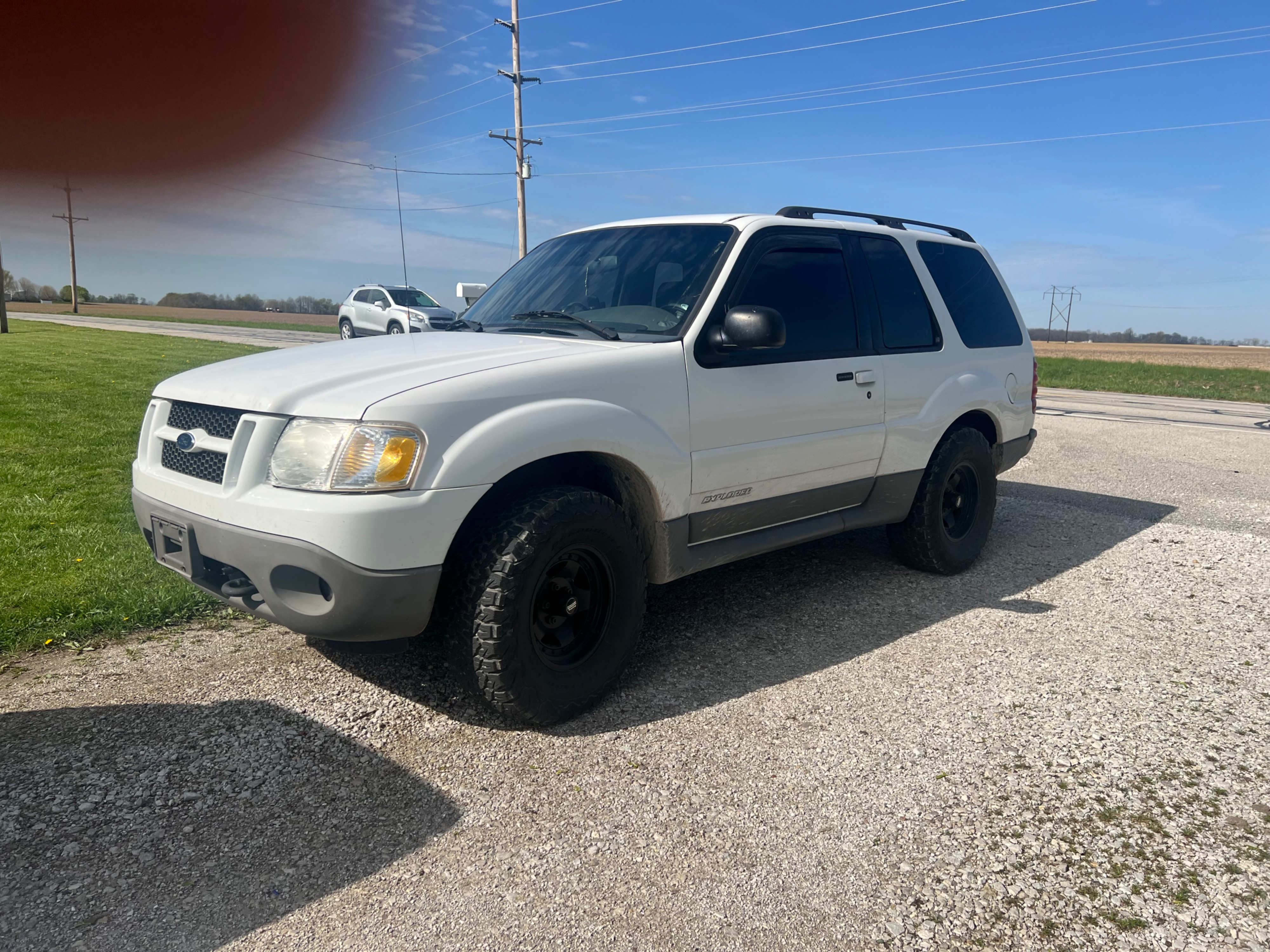

Having transmission woes in my 2001 4x4 Sport with the old build date but I found a recently rebuilt 5r55E out of a 2001 4x4 Explorer with the new build date..
Just wanting to confirm what I’ve read online
This will work and all bolt up and run fine.. I’ll just have an extra electrical plug that I won’t be using since mine doesn’t have the updated transmission?
