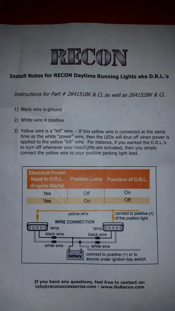

Where do I begin? Well, the lights were "universal 6-LED" drl's. I mounted them under the bumper and all looked great. Time to run the wires. Well, the sheet that was given to me for assembly was the following:
I hook up everything as above and wired the white wire to the accessory source in the fuse panel under the hood. I turned the lights from the off position onto the On position. Tried it numerous times and everything worked good. Only hitch i noticed was if the car is running(and DRL's are on), if you open the door, they go out and park lamps come on. Closet he door and 10 secs later, DRL's come back on. Im guessing this has something to do with courtesy lights when you enter/exit the vehicle. I thought I had it right but its all over the place now. First it was the park lights that would come on. Now, just the fog lamps turn on and go out after 10 secs. And now, 3 nights after install, when you turn on all the lights(manually), now the DRL's come on as well. Its like it changes the way it wants to operate daily.
