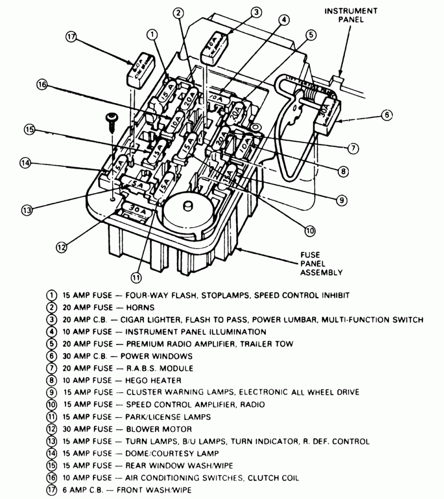

Hey guys posted a similar question in a searched thread had no hits, trying to figure out why my brake lights are out I'm thinking multifunction switch cause I've replaced two brake pressure switches and no change, I've replaced bulbs and, checked the fuses #9 & #13 I believe. The fuses show no power according to a test light on either side of the fuse. Just needing to know if I'm going down the right path or is there some other thing I should check. I also have no emergency flashers

OMG just fixed it found in wiring diagrams fuse#4 which works hazard flasher was the culprit, damn i feel like a idiot
Glad you found it before buying more unneeded parts, especially an expensive MFS. Was it fuse #1 instead of #4 ? :scratch:
