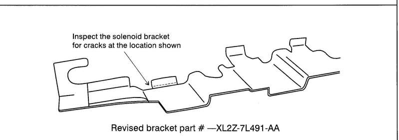

Wasn't thinking when I pulled pan, but there was a chunk of metal in the pan. About 3/8" wide x 1/4" tall x 1/16" thick. looked like a tab that broke off something. Couldn't find anything (didn't know where to look). Now I think it might be the bracket that holds the solenoids. I will check when I drop the pan again.
What my plan is:
Drop pan and VB
redo the VB with the Ford TSB
Superior boost kit?
Change the TCC and probably the EPC (the truck has 80,000 miles).
Put it back together and see what happens.
Any other ideas or suggestions are appreciated.
