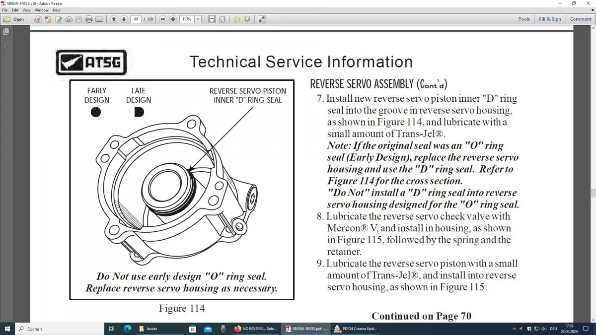

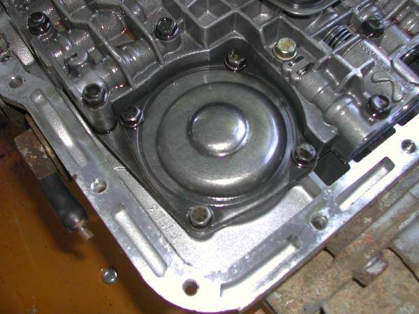

In post #10 the picture references an "O" Ring in the servo housing . Can anyone tell me the part # or another way to get it? I'm going to replace the servo and want to replace the "O" ring while I'm in there. Thank you
