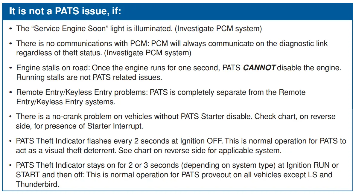

I don't have statistics to back up the following statement, but unless something unusual happened, the most common cause of PATS preventing starting is the transceiver module around the ignition lock cylinder failing. It is not coded nor any programming needed, is a simple plug and play swappable part.
