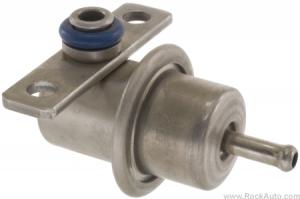

Another possibility is that the fuel pressure damper located on the fuel rail has a busted diaphragm.
Pressurized fuel is on one side of the diaphragm and manifold vacuum is on the other side. When the diaphragm ruptures with time fuel gets sucked into the intake manifold and finds its way to the head intake ports. If there is enough of it the head gaskets will blow.
I suggest that you disconnect the vacuum hose to the fuel pressure damper and check for the presence of fuel.

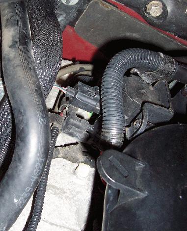

Which vacuum hose wasn't connected? The following post shows the upper intake manifold and identifies the vacuum connections: Intake manifold vacuum lines
I wasn't implying the engine had been damaged by the previous owner. I was just pointing out that when fluids (fuel, water, coolant) get sucked into the engine damage can occur.
I don't know what they are called but they are thin red and black on the passenger side right under the ac line. on your post I think you labelled it as number 4

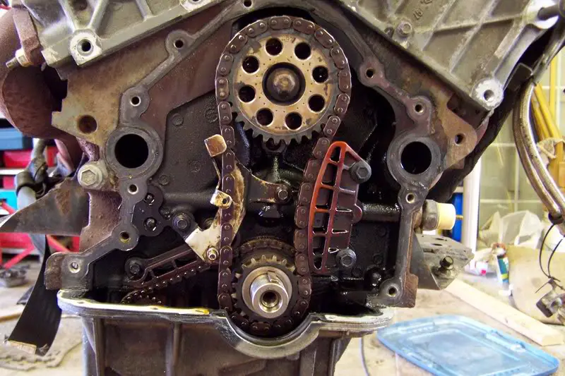

If your problem is camshaft timing related is must be due to the jackshaft since both banks have low compression. The primary (crankshaft to jackshaft) chain rarely slips even when its tensioner has completely failed.
There just isn't enough slack in the chain for it to slip a tooth on the sprocket. The crankshaft sprocket is keyed so it can't slip on the crankshaft. What normally happens is the jackshaft sprocket retaining bolt loosens and since the sprocket isn't keyed the jackshaft slips relative to the sprocket. The right hand threads on the jackshaft sprocket retaining bolt keep the bolt tight during normal engine operation. However, when the engine backfires or rapidly decelerates the crankshaft force on the chain can loosen the bolt.

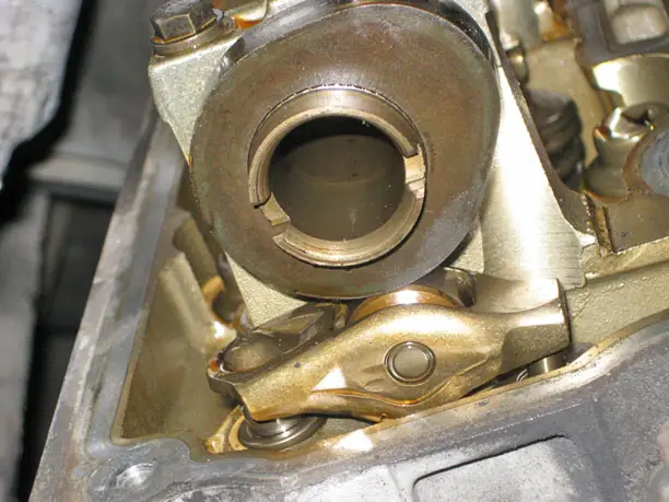

When injectors sit for a long without being activated they have a tendency to stick. However, they usually stick in the closed instead of open position. I doubt that stuck open injectors is your problem. There is a very remote possibility of a wiring error or short that could energize all of the injectors to open. The red wires to the injectors have battery voltage when the ignition switch is in run or start. The injectors are energized by the PCM when it "grounds" the other wire to the injector. There is a unique wire between each injector and the PCM so if all 6 of those wires were shorted to ground accidently they would all be energized.
The OHV V6 has a reputation for blowing head gaskets when the engine overheats. It seems to be less common on the SOHC V6. How long did the engine run when you first started it? It is difficult to purge air in the cooling system on the SOHC V6. Did the engine run long enough for the heads to overheat?

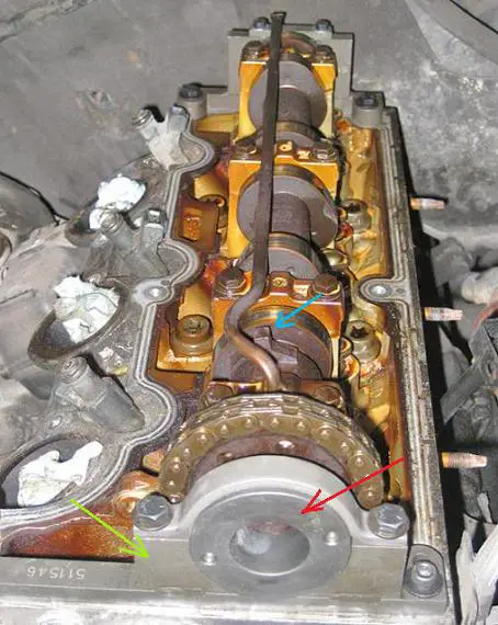

When you get the valve covers off check the camshaft timing. When the crankshaft is at TDC with cylinder 1 on the compression stroke the timing slot in the end of each camshaft should be below the axis of the camshaft and parallel to the head surface that mates with the valve cover.
TDC
Cylinder 1 on compression
Timing slot
TDC
Timing slot
