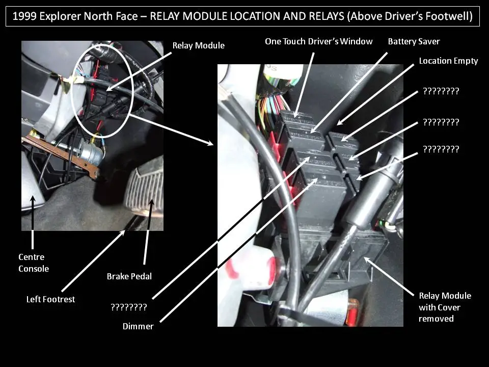

In this picture (right hand side) where you have the words relay module . What is the cable that runs across the picture. it has a bulbous bit in the middle which has a wiring connector on it. Should it get hot? I was using your thread to check a battery drain and was looking for the relay box when I noticed it was hot.
Thanks
Hi Chrystal. I have no idea. All I know is it was in the way when trying to look at the relays. I'll try and have a look though. GRoB.
Thanks - apologies for seperate post but I was well into panic mode at that point!!
