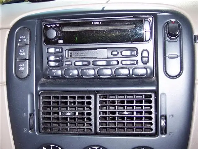

I installed my switch for my fog lights in there. I know that my switch blank is not removable, they are molded in. If you had the message center then the 4x4 buttons would be there and the message center buttons would be where your 4x4 buttons are now. I bought a radio bezel on eBay for the fan speed switch and noticed that the switch blank is removable on that one. The switch blank on the '03 might be removable.
My fog light switch:
Hope this helps out! :biggthump
My switch blank IS removable in my 02 XLT. I put my switch for my brown wire mod in there. It even has a part number on the back, so if you cut into it and don't like it, you can order a new one.
Mine is also removable. Slipping a thin knife into the edge it popped right out. Bought a couple of different style switches to see what would fit and look best. The one I like best a round rocker switch is a little too big, it would fit but just barely and I think it wouldn't look right, but the rectangular lighted rocker switch that seems to be just the right size. I'll do some cutting this week and see how it comes out. When I opened it up there is no wiring at all behind it, at least not within reach. Will have to figure out a run to get hot and ground wires to the rear of the panel. For now I figure to mount the switches and figure out what to use them for and run some wires. I'll post some pics when I get them mounted.

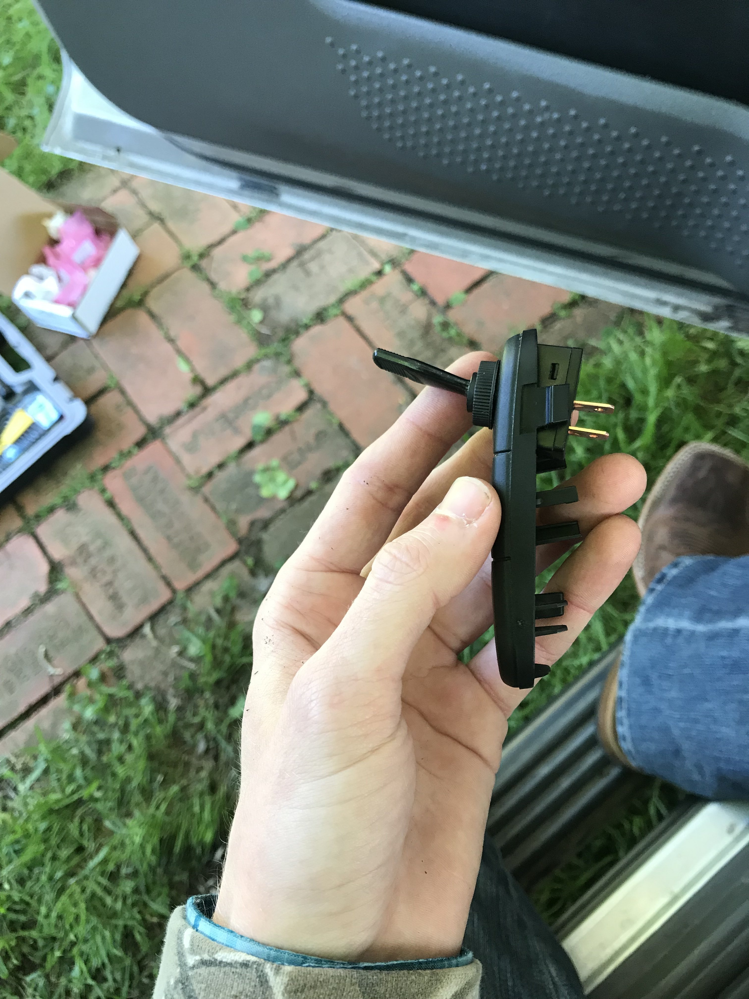

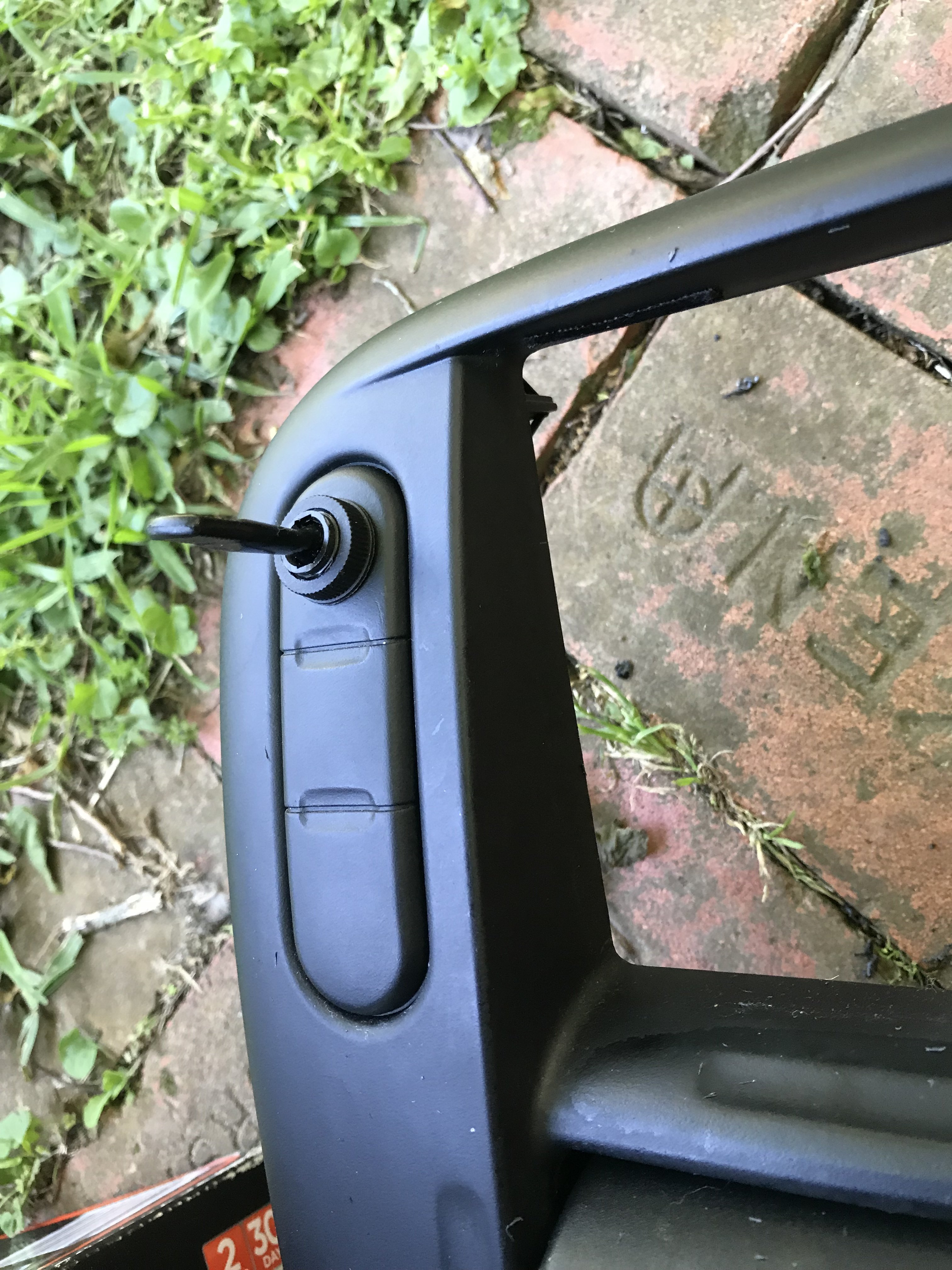

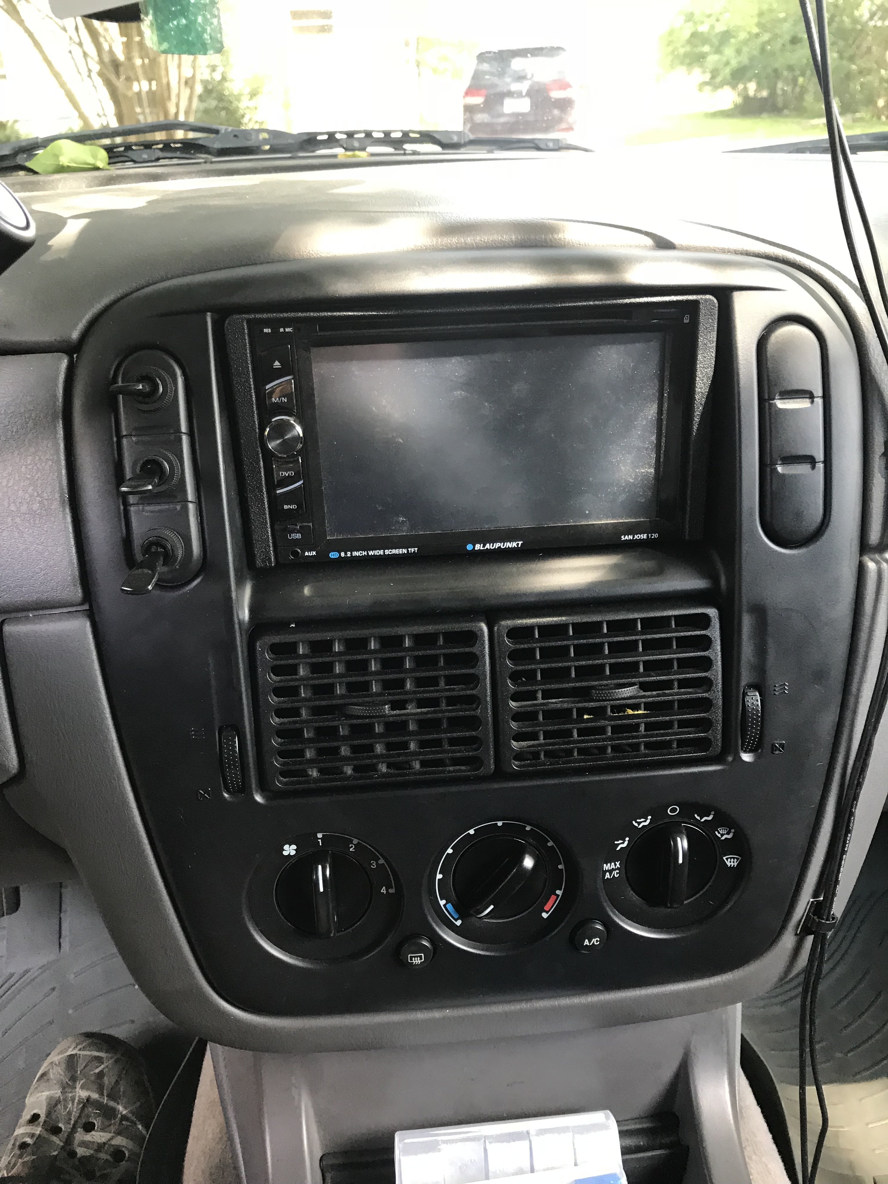

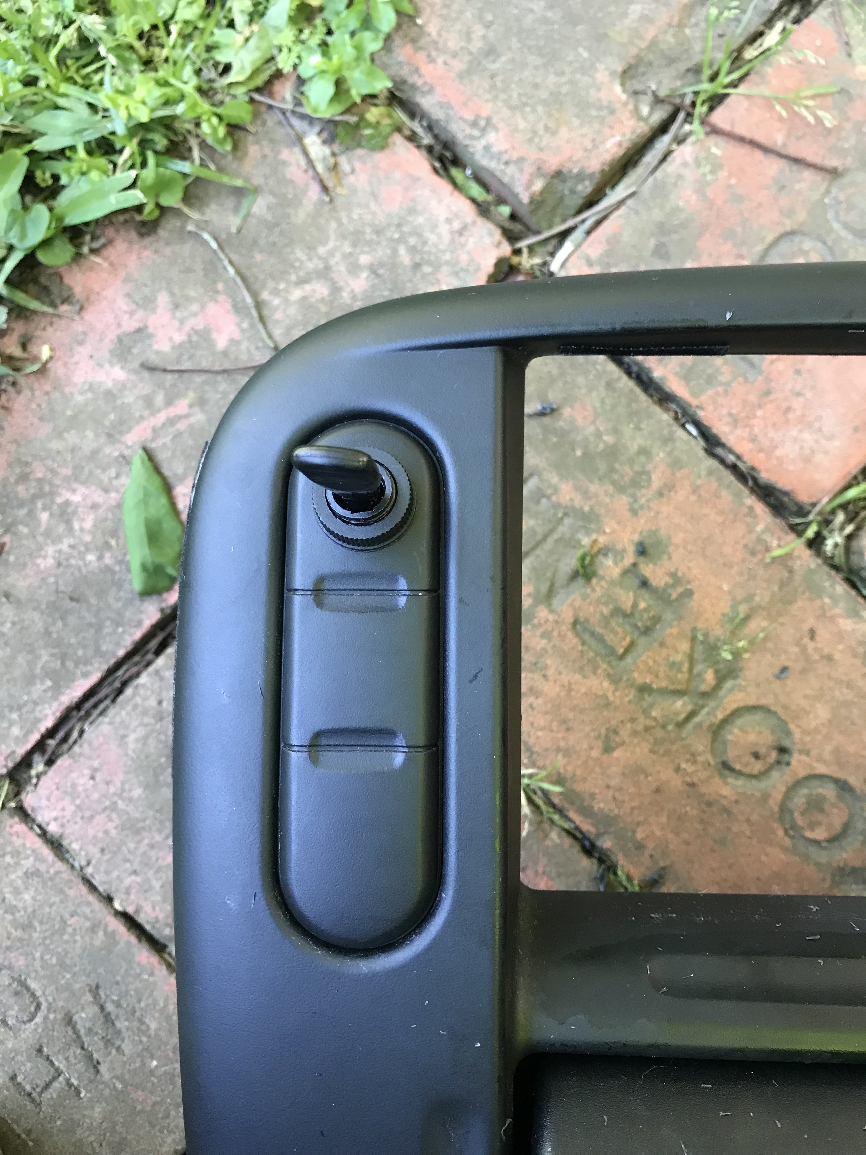

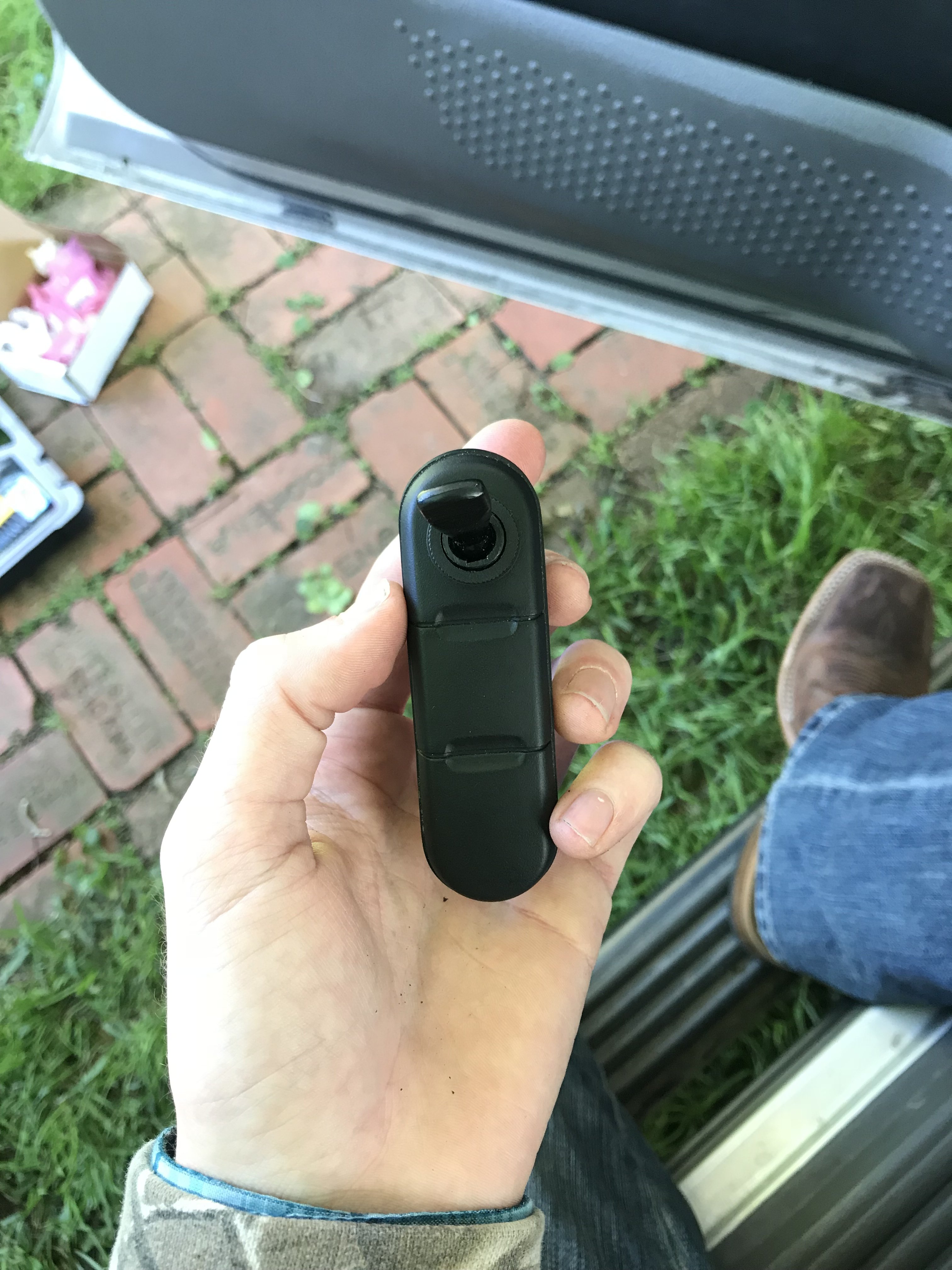

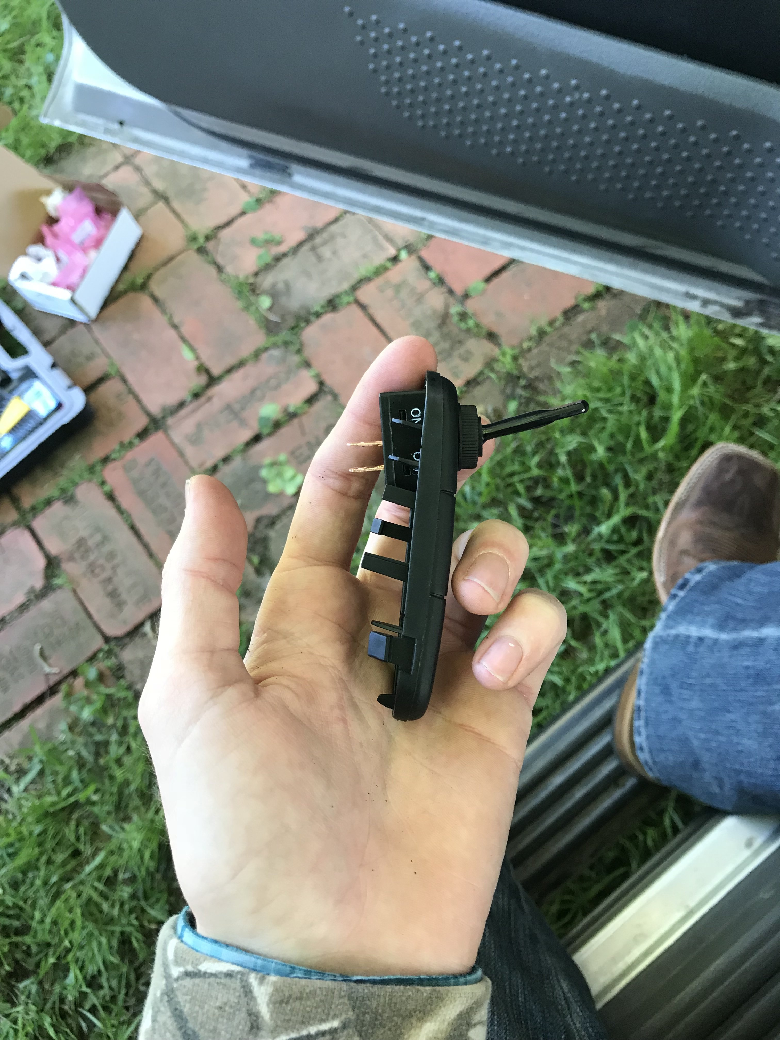

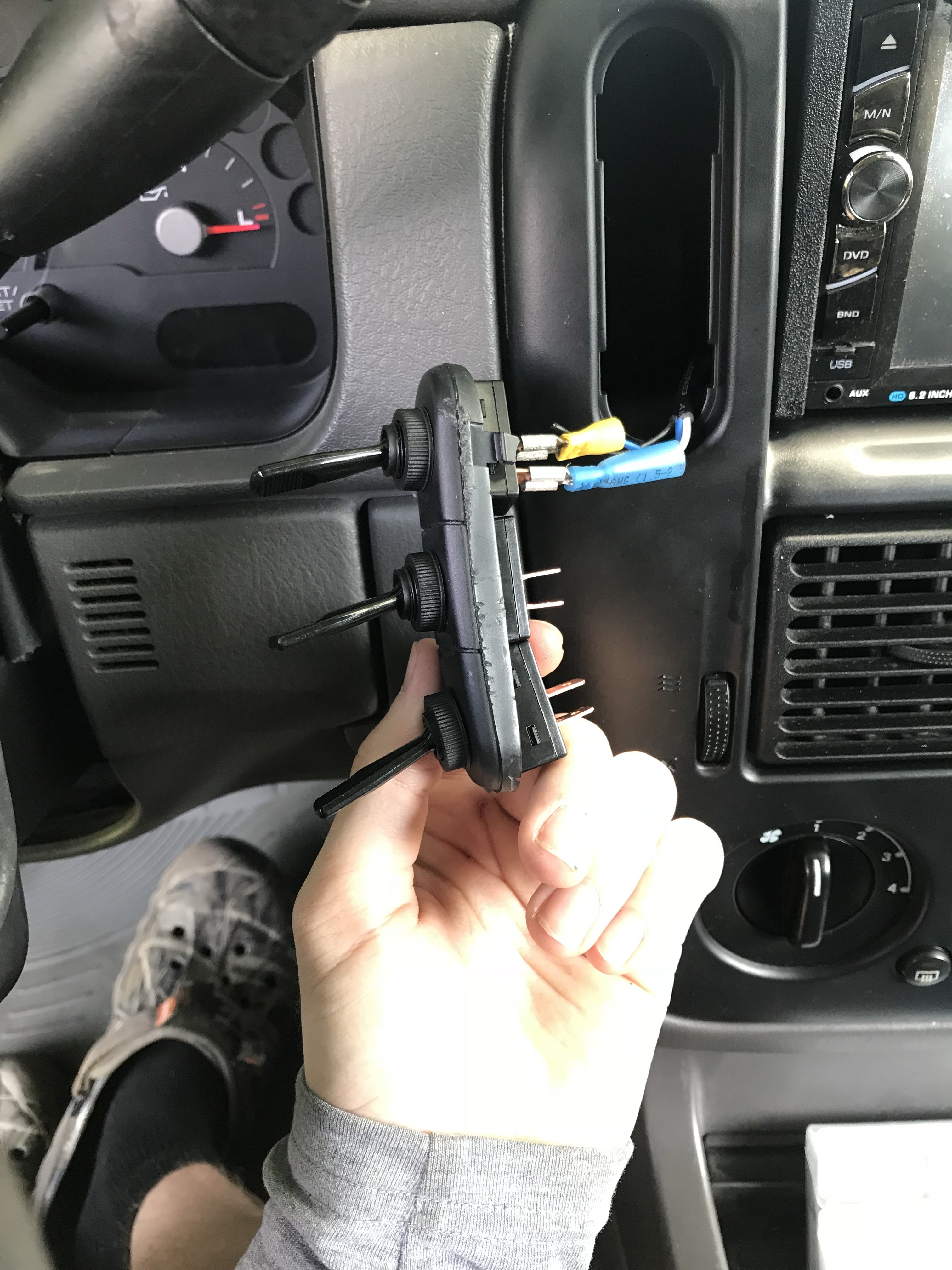

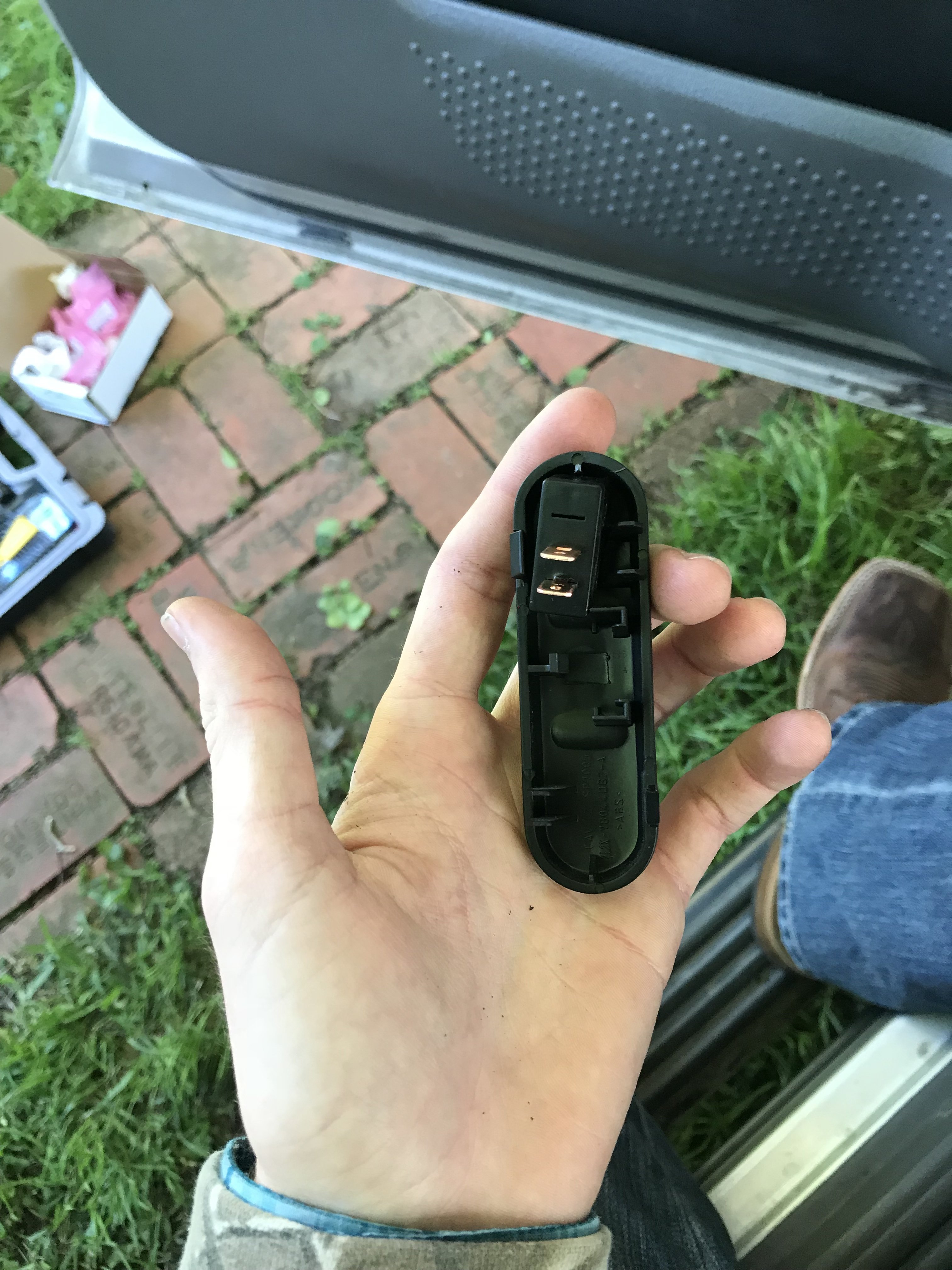

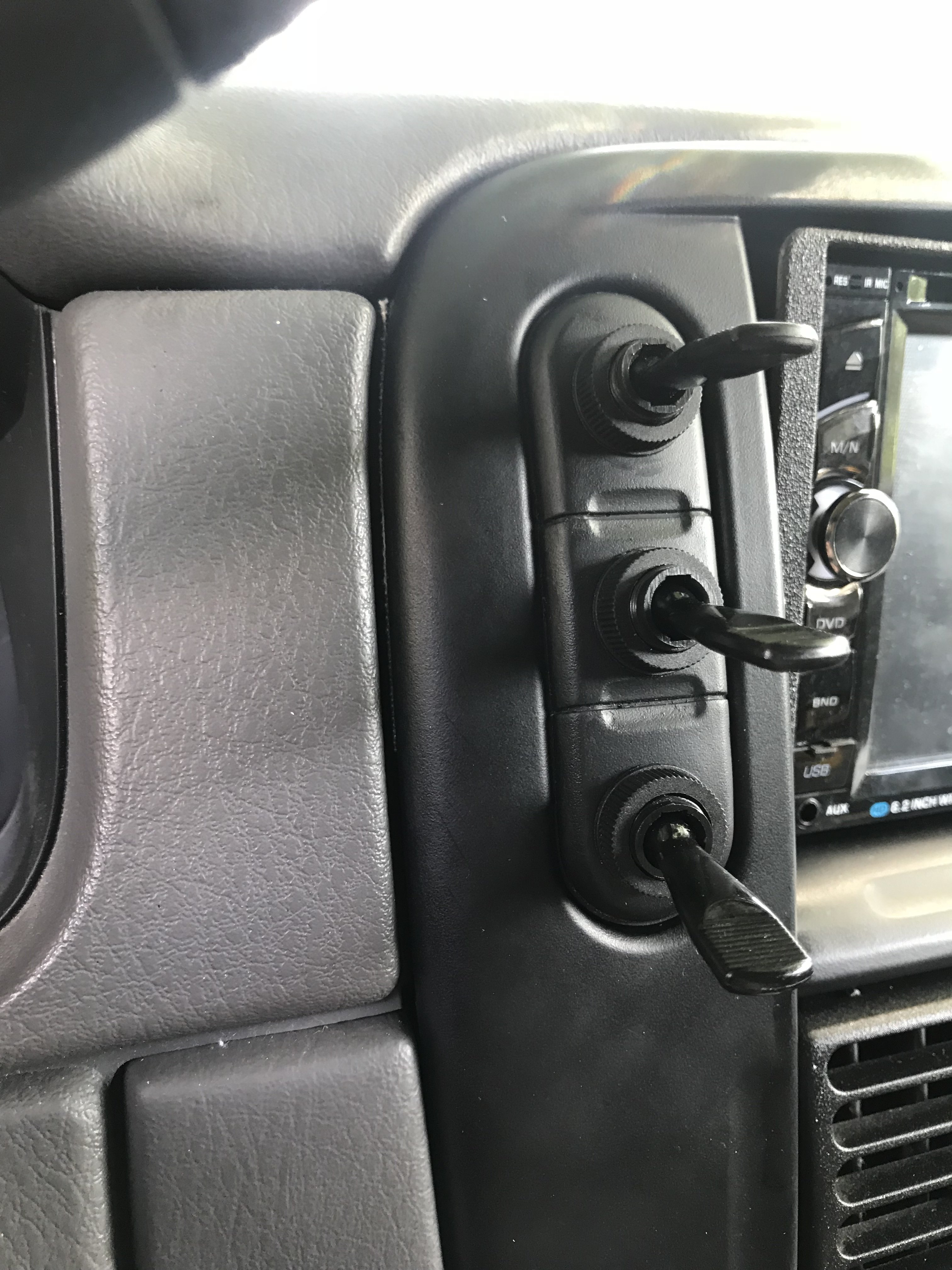

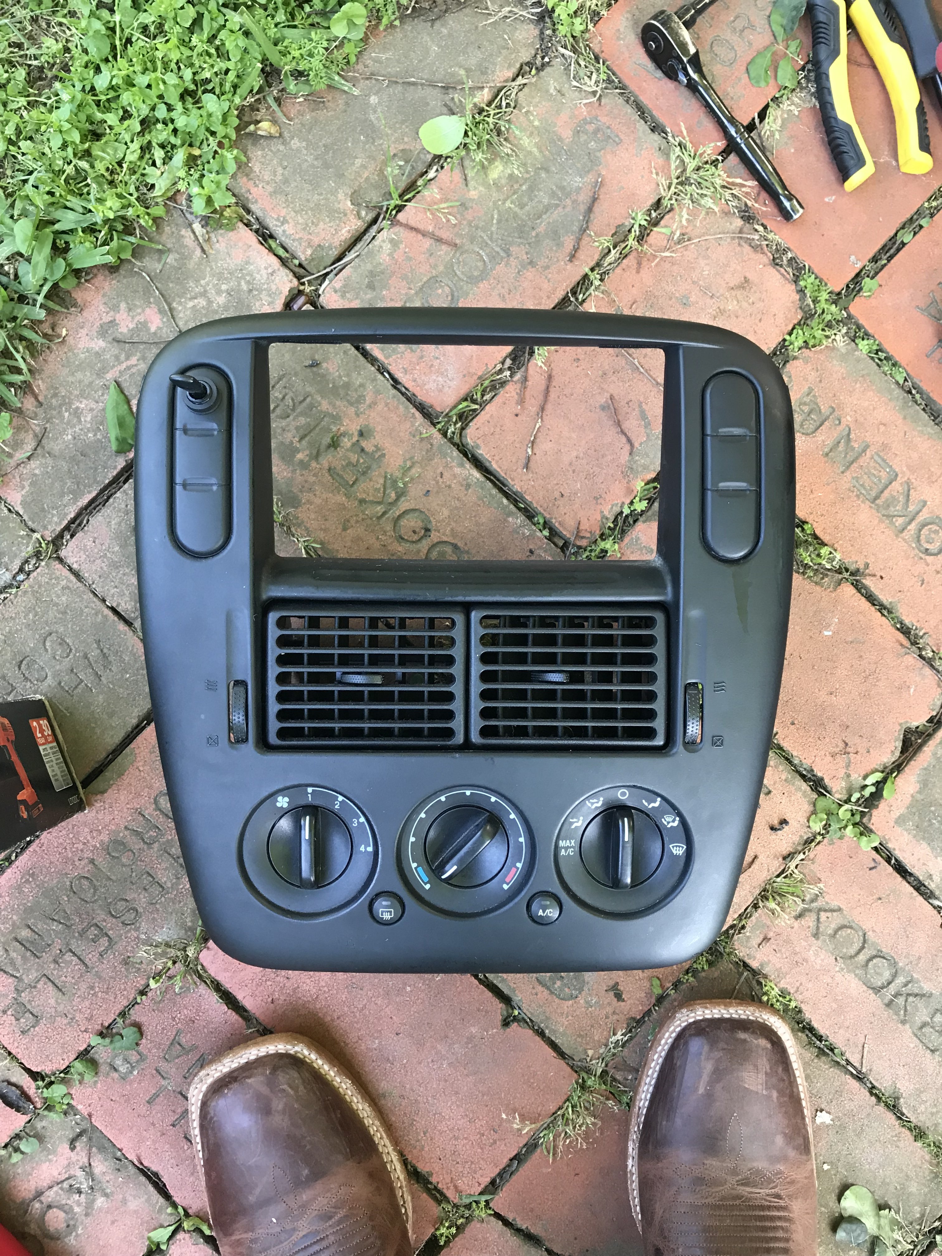

I have an 04 XLS 2WD so both sides are blank, and I just repurposed mine for a future project, how’s this look?
Update added 2 more holes and switches, took a lot more work than the first! Using one switch for light bar and 2nd and 3rd for the future!
I’m looking to do a very similar mod with my 03. Do you happen to remember the exact switches you bought and what tools you used to install them? Looks great!
