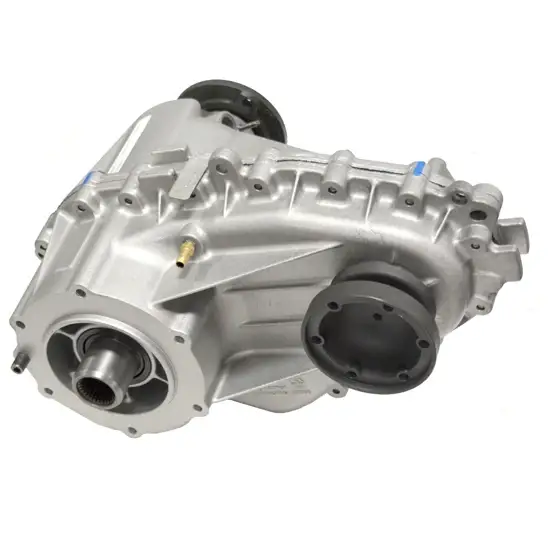

My case looked like this when I put it back in after rebuild, and other than the grease melting at the cup for the CV coupler it still is this clean
