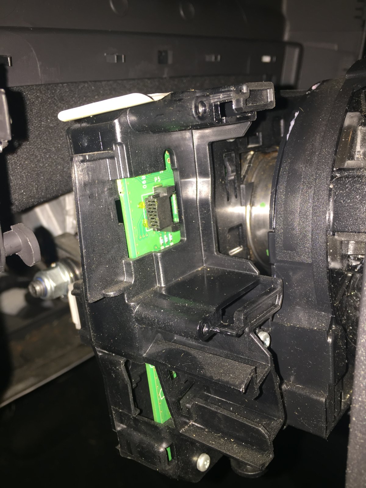

Pull the switch back out and look at the contacts where the switch connects to the steering column control module (the main shroud area) may have a bad connection here. Take a picture and post if you can.
jzcop
January 17, 2006
19
clifton, NJ
2013 XLT
so here’s pics of the connection at steering wheel. no burn marks or broken prongs. i put the old switch back in and still same issue. i’m thinking it’s a program issue as i saw on some posts that the speed of the blinks and other functions of the switch are programmable. or it’s the circuit board at the steering wheel. either way i may have no choice but to take it to the dealer ughhhh.

Number of turns is programmed but the fact that left works and right doesn’t doesn’t sound like programming.
Do you have forscan? You can scan the SCCM and see if it’s reading the turn lever correctly. If it’s not it could still be the connection. How many pins are on the connection? The input pin for the right signal could have an issue (bad circuit trace, bad coupling capacitor, or bad pin on microprocessor of SCCM).
Either way I’m pretty sure it’s the connection or the SCCM itself. The SCCM takes the input from the turn signal switch and broadcasts a turn signal message on CAN bus. If left is working fine then this Bus connection is likely good.
The SCCM maybe able to be replaced by the user using forscan. I think you may just have to copy the as built data over to the new unit.
@jmr061 you know anything I don’t about SCCM replacement besides as built programming? Any calibrations, etc?
