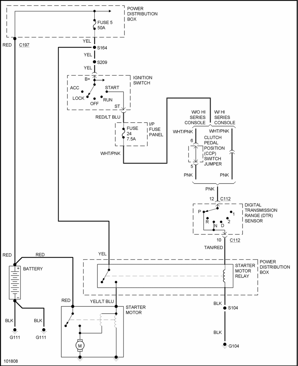

So today I was doing a little bit of offroading in my 01 Explorer Sport 4x4 4.0 and it just shut off. No weird noises no nothing and it would not start back up. When I turn the key literally nothing. No clicking, no cranking, nothing. The theft light is not blinking so it's not pats. I tried tapping on the starter but nothing happened. Battery is good and has charge. Anyone have any ideas? I would try to jump the starter from the battery and test it like that but access to the starter is very poor with the 4x4 system. I would probably have to take the front driveshaft off to take the starter out.
