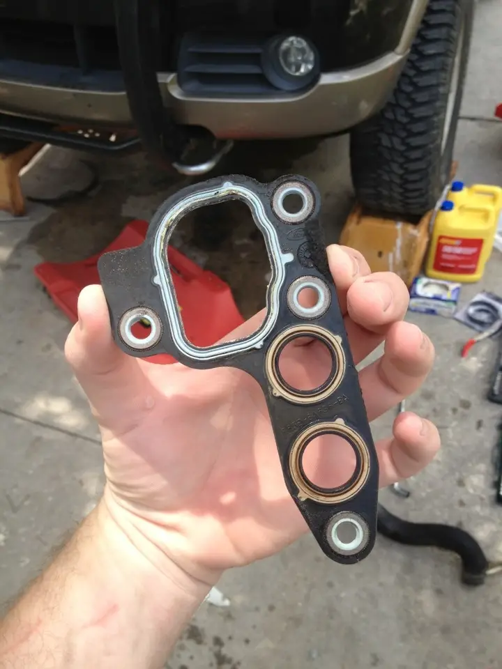

I changed out the gasket today, it took me about 3-1/2 hours. Here's how I did it:
First drain the oil, drain the coolant, remove oil filter, remove radiator hose at radiator end. Remove two 13mm bolts from oil filter housing from underneath. Take driver's side wheel off, pull back rubber flap, access the top two 13mm bolts. Remove housing with hose attached. Clean off mating surfaces of housing and motor, refit in reverse order.
It took me a long time due to not being able to remove the top two bolts, probably easier if you remove the coolant hose, but that was difficult with the type of hose clamps that were on there. The gaskets have the year of manufacture on them - this was the original gasket with '01 on it, the new one has '13 and you can see that Ford has changed the design a bit.
The gasket looks like it was leaking for a long time, so this was a pretty dirty job.
Hopefully no more leaks.
