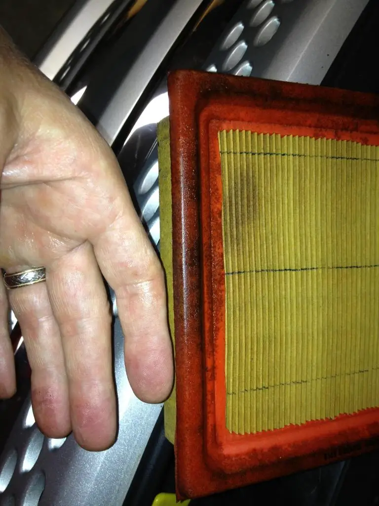

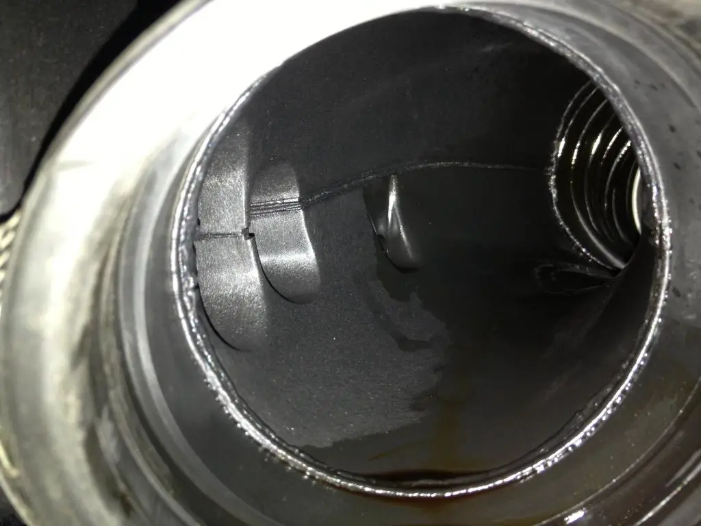

Here is my situation...going to call dealer today to arrange a fix for this. This pic is of the outlet of the air filter box.
Here's the inlet piping
And a oily air filter element
Exactly what mine looked like. No tsb but Ford hotline will tell them to replace with updated valve cover.
