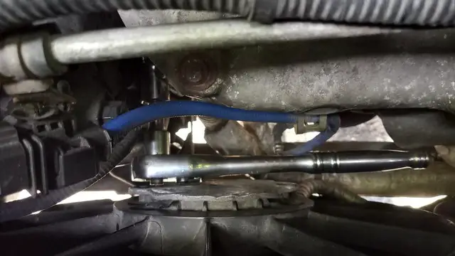

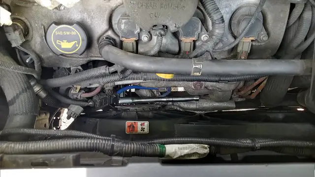

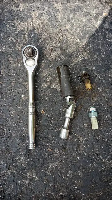

This thread really over-hypes how bad this job is. I had my oil pressure sender fail today on the way home and replaced it this evening after picking up a new one from the parts place. It took literally 20 minutes to replace the sender, I didn't remove anything other than the sender its self, and I didnt use any special tools. A deep 13/16 socket, a short extension, a swivel and a ratchet got me right where i needed to be from above.. Unwind the old one, wind in the new one, piece of cake. For what it's worth, you can see it from underneath, but can't reach it. You can reach it from above but can't see it. I did put the car on ramps to get a look at what was going on, but took it back down and worked blind from above to do the actual work.
Did yours go with no warning? Mine just did.
My 2011 with almost 280k miles had been giving me low oil pressure warnings after it warmed up at RPMs under 1000 for the past week or so. I just changed the sensor this morning, took all of 10 minutes. 21MM Deep socket, extension, swivel, just like imheretoparty described. I did mine from underneath, front end up on jackstands. Apparently it had started leaking since the last oil change, the bottom of the AC Compressor was wet with engine oil. I do my own oil changes and give the lower engine a look over while down there. One note, be quick with taking the old out and putting the new in, as there is some oil leakage. Trip into town and back, no warnings. Now to figure out Forscan to disable my TPMS!!
