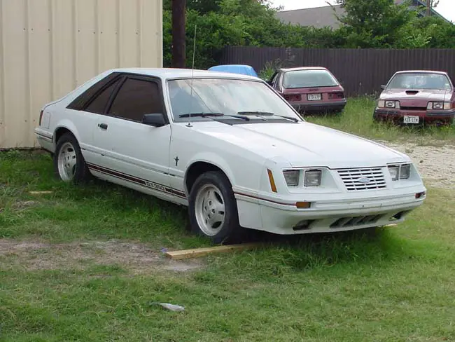

This is a 1984.5 20th Anniversery GT350 Mustang, the owner (my client) and I dub it the GT350R, I'm retro fitting it with an 03' Cobra motor and a custom built PA 4r70w tranny out of an F150.
Just though I would share some of my work with you all.
A couple of you on this board have seen this in person.
This is how it started 9 months ago.

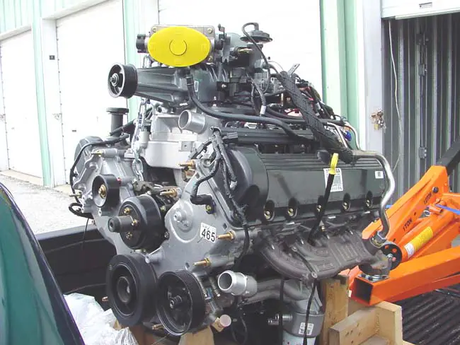

And here's a real 03' Cobra engine bay

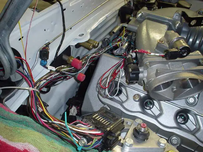

All wiring was re-hand made from a 96' GT harness.
As you can tell from some of the other photo's this is not being built in some high zoot shop, this is your regular ole garage.

And now you pry now that it's quite a bit of a pain in the arse to get a dohc modular engine to fit correctly in a fox body lol. I've only seen one done, an LX with a stock 03' Cobra engine, no other mods and the damn car pulled around an 11.4 at 120 mph I think. Could you imagine what just a few bolt on's would do to that little sucker considering how well the 03/04 Cobra engine responds to mods:eek:
Right now my friends 03' Cobra is putting down about 615 rwhp with a Kenne Bell blower on pump gas and is still tuning for more. He still going to be adding nitrous also for around 700-750 rwhp and also to cool the intake charge mainly.
I can just see his engine with the KB blower in a light Fox Body, that car would be a little rocket with the powerband of the KB, you'd have a car that easily could run in the 9's with full reliabilty if setup correctly.
By the way, clean install, swapping in the modular engine into the fox bodies and especially the classic 60's cars is not easy. Looks reall nice. About how long did the engine swap take in your case?

I have so many vested hours in this project there's no telling, as for the basic fit, it went right in, I did have to raise the engine and move it forward about 1/2" though.

To add a little to the mix, the 03' Cobra and 99' and up SN95 platforms are 2" longer from the core support to the firewall, AND as you can tell the fox bumper cover slopes back and under in the front making the liquid to air intercooler a pain to mount, because the 03's bumper cover goes straight down past the bumper re-enforcement, so packing the intercooler a HD tranny cooler and PS cooler and condenser and radiator, in the front was a chore.
Not to mention that I wanted to hide as much of the wiring behind the inner fenders as possible that ment sectioning the harnesses and removing as much as 8" in some areas:
