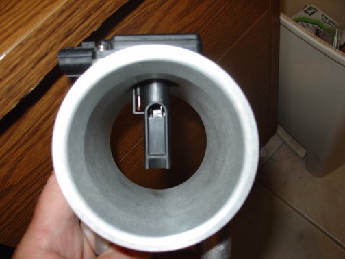

C&L manufactures the MAF body for Vortech. Of the photos you posted, there is something different about the Vortech over the one Aldive and I got. I don't remember the specifics. Some sort of tube that's in the Vortech but not ours. I don't have a clue how that impacts things.
p.s. here is what Doug said: "They are the same style, made for Vortech by C&L but they are the older style with the sampling tubes."
Not sure what a samping tube is.

Hmm...I see the tubes in the vortech ones (pic I posted). I was not aware that the C&L did not have them. At least, I don't recall seeing a pic of the inside of one. I wonder what the difference is. (puzzled smilie)
They can both be purchased for almost the same price (for whichever is better). Summit has the vortech for like $122 and jdsperformance has the C&L for $110. I do not know anything about that company though. Maybe when I get rich I will try it. LOL
I have spent my limit until the next payday.
The inside of the C & L MAF ( housing ) is perfectly smooth. The stock electronics fit in there as shown in the picture.
Now I have officially seen the inside of one. Ask near aldive and ye shall receive. ;)
Thats cool to see the difference. In the other shots, they look the same.
Celly said C&L makes the vortech housing so that makes sense now as well.
