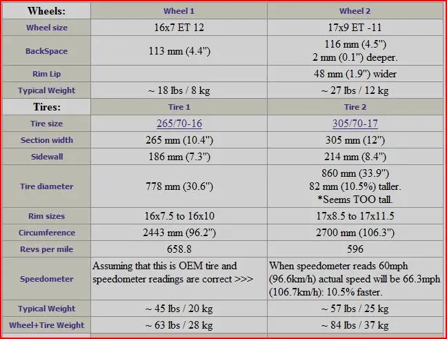

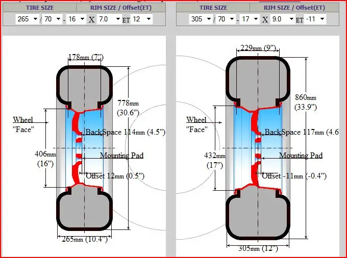

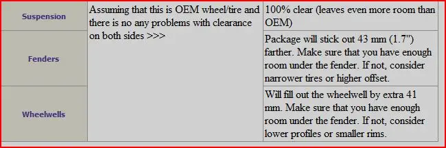

After way too much thought, for many months. I ordered a wheel for my ST.
I choose the Black Rhino Sidewinder. 17x9 with 4.5 BS
Now onto tires. I'm going to go with a 33x12.50x17 or a 305/70/17
I've been looking at Toyo Open Country MT, Mickey Thompson MTZ or Cooper Discovers MT. Does anybody have any experience with these ? Mostly going to be used in the Sand Dunes, with a little mud. Drive about 6K/year.
Here is how it should fit on the ST.
