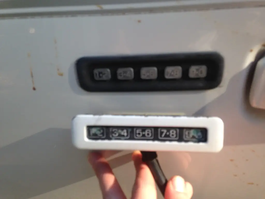

First mods complete: Replaced key pad with newer style one. It is plug and play and looks better because the buttons are not worn through. I do need to paint the plastic to match the door color.

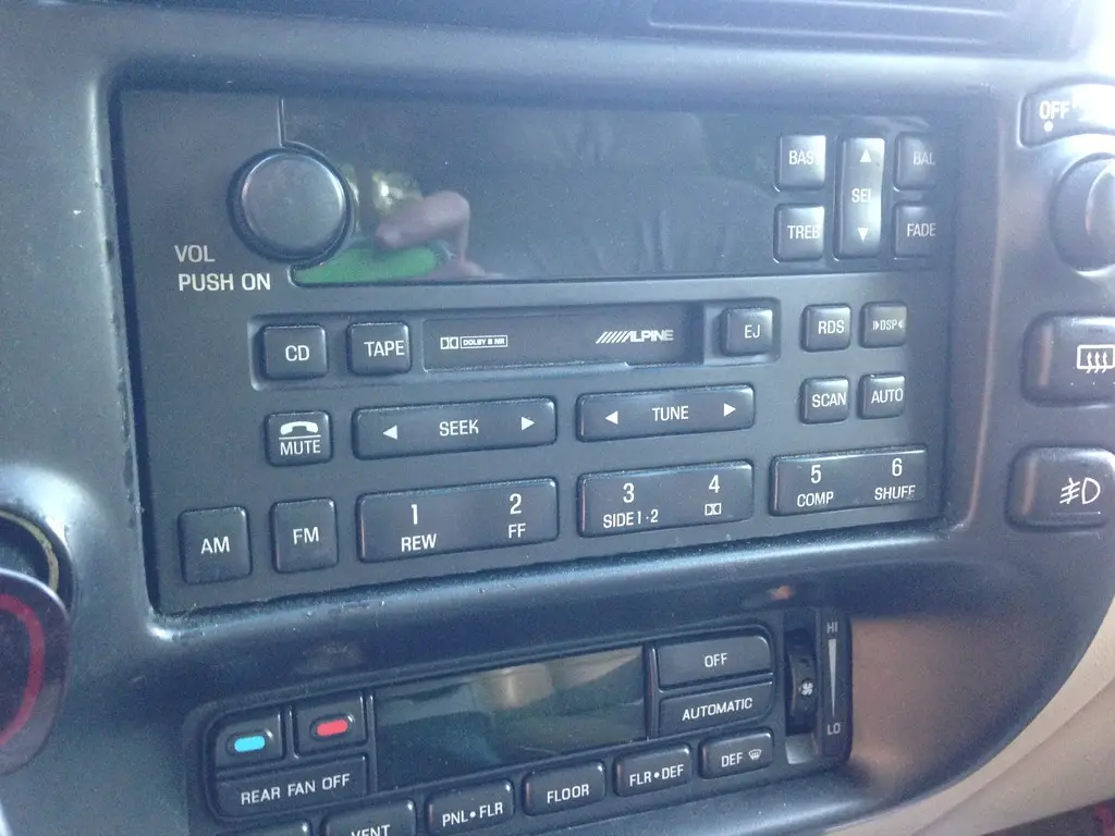

Second mod: Replaced factory stereo with non functional display with one from a 2000 Lincoln Continental with the factory Alpine system. The wiring harness was plug and play and everything works including the 6 disc changer, steering wheel controls, and rear subwoofer. Its a nicer looking stereo and sounds greats. I did have to dremel around the radio to get it to fit in the stock location.

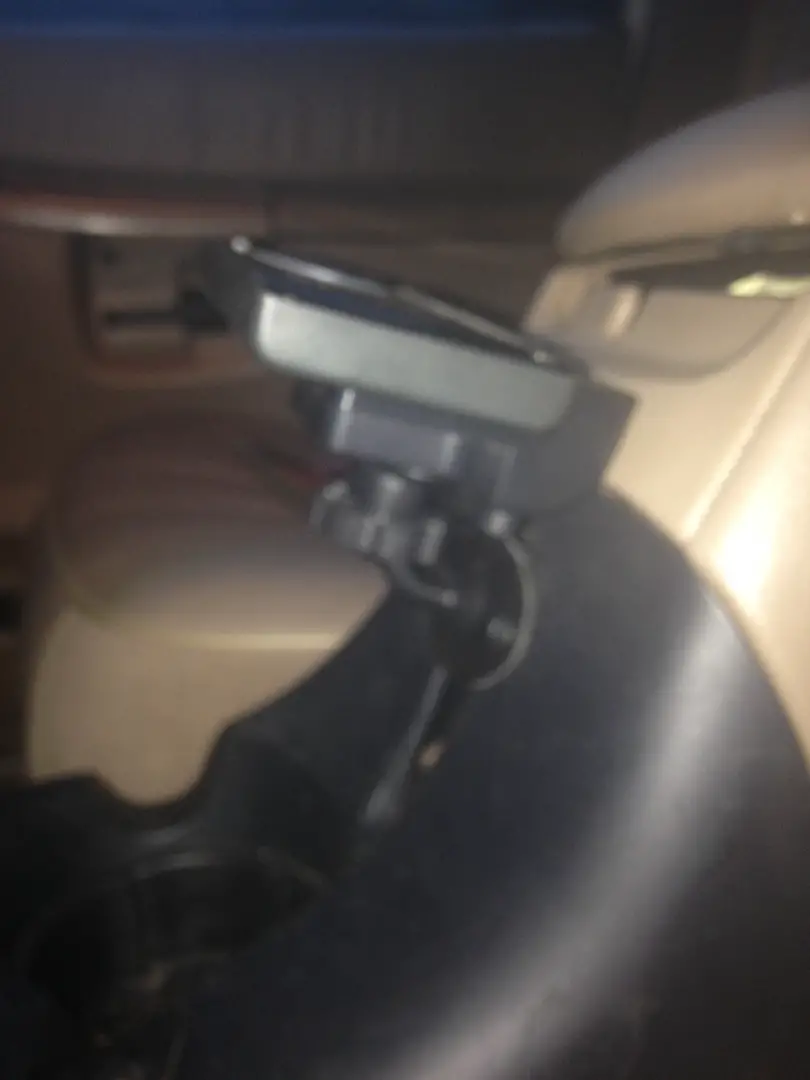

Today I installed an XM radio receiver but I'm not sure if I like the place its mounted in. What do you guys think? Eventually, I'm thinking about installing a double din touch screen Pioneer stereo but I don't want to lose the steering wheel controls. I will have to look into adapters so the new stereo will work with the stock steering wheel controls.

Here is a sat receiver mount idea I've seen.
If you find some limited seats with bad covers but good seating elements you could just put your covers on those too.

I can really appreciate the time, effort, and workmanship that went into completing that set up. With that said, I don't have the patience to modify the radio bezel. The Pioneer double din stereo I will be acquiring will have all the necessities I need. It has bluetooth, xm, and iPod controls.
The xm receiver I installed is temporary and I think the double din will be much cleaner.
The plan is to find limited seats. Pretty much all the leather seats at the junk yard are very worn so that should not be an issue.

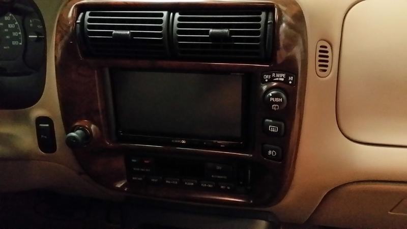

You'll love the double din. Here is mine - a Kenwood DDX9902s with Apple Car Play and Android Auto I just completed.

The double din installation looks awesome. I have been following and admiring your progress with the installation of the Saleen hood and spoiler. Keep up the awesome work. I'm thrilled to see people are still breathing life into these older Explorers.

BTW, based on your post about installing the Lincoln/Alpine system, I found one to replace my broken display original, and it works perfectly, even bringing the CD changer back to life (even though I will likely never use it!).
I like the the heated seats so far. I just hope they last!
I'm glad the Alpine stereo out of the Lincoln worked out well. Its a cheap alternative and retains all the stock functions which is great!
