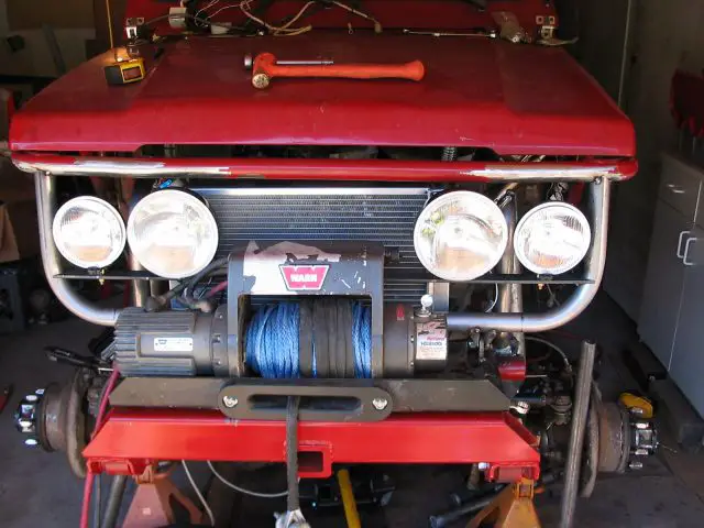

Part of the problem of this whole engine replacement, is the radiator. you can't use the stock zuk radiator - it's too small, you will overheat. So to make room for the the new radiator, I've had to cut apart the old tube front end, and make a new one. In the process I have found a few other problems, so I decided to fix them too.
One thing I always wanted was to get both sets of lights down - the PIAA's was just too vulnerable I felt. So, the new front end. I am going to use the small 5"/55 watt driving lights as low beams, and wire in the the PIAA 80xt's as high beams. The PIAA's are way to bright to run as low beams.
I also have figured out how to bolt the tube clip in. The old way was a set of welds and bolts - now it will be just bolts. This will make service later easier to perform.
Last, I am moving the shocks back to hoops, and limiting the up travel to 3.5". Not a whole lot, but if I do not do that the axle will smack into the oil pan, and that is a bad thing. In doing this, I also have decided to re-work the bump stops, and planning on switching to compressable bump stops (instead of the non-compressable type). The reason for the switch is due to the small up travel; I want to start slowing everything down earlier.
