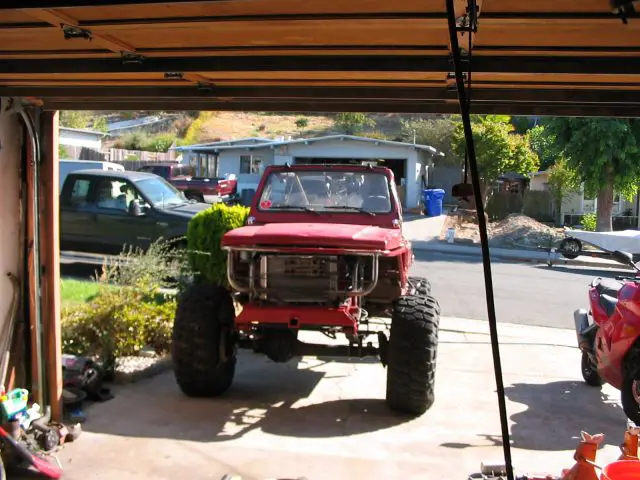

Got it finished enough to run outside..
Also installed 2" wheel spacers; the 3.75 bs was just too tight. Now I've got plenty of space, so I can turn the steering stops in closer.
