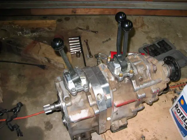

The new shifters bolt in; the old shifters had a clip to hold them into the seats.
So I have cut a bigger hole, to get access to the bolts that hold the shifters in place.

Got the tcases back tonight - no more river of oil when it's on it side.
Also makes gives me lo-neutral-hi on one shifter, and front in/out on the other shifter.

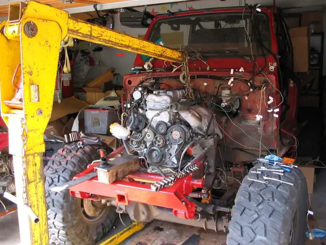

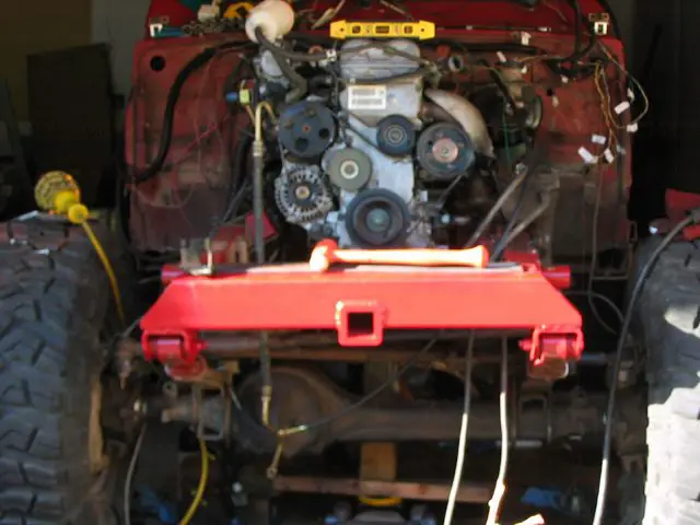

Got the transmission, tcases, and everything hooked back together, and stuffed into the zuk.
Still need to build engine mounts (Sunday!)
Add to the list:
1) Find the A/C delete belt. Autozone/Kragen's web site list them, but as a special order item. This also means I'll be mounting up the Puma 12v compressor I have in the back area.
2) Build a new thermostat outlet. The factory one dumps straight in to the FJ60 power steering box. I have the 1.75" tube, 5/16" plate and enough welding skills to make a new one. This will solve the radiator hose problem too - I just have to get 1.75" sized hose. The outlet is 1.5", and the stock hose is 1-3/8" - close enough that I think I can get it on there.
Other than that, it fits pretty darn good in there. I may drop the tcase down 1", to make more tunnel room.

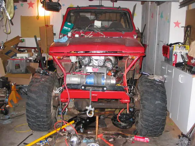

Got the engine mounts fab up, and installed. I had to make a new thermostat housing; the factory housing points straight at the FJ60 box, and is un-usable. I also put the front hoop back on, because I need to start the process of figuring out what goes where. I then layed the hood on it... Stood back, and realized everything fit back together! I have 1" of clearance between the engine and the hood. I have 5.5" of clearance between the oil pan and the front axle.. and I have only 4.5" of up travel in the front, so looks like I'm set!
Now, I am going to replace the front headlights with straight 55w lights, put the PIAA's 80xt's I have in as high beams, and do some re-tubing of the front to fit the new radiator properly, make a winch mount, need to finish re-wiring for the new ECM, lights, and power. I also need to get some new hoses for the power steering, the 2 liter lines are banjo fittings and the FJ60 box is flare. I also have replacement gauges for the oil, temp, and 12volts.
