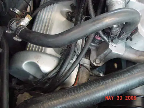

Heres a thread I posted when comparing my mechanical to digital gauge.
http://forums.modulardepot.com/showthread.php?t=85651
I was looking at the picture in that link about adding a sending unit inline with the heater core hose:
Why is this more accurate than the location of the sending unit on the engine? Is the tee made out of a galvanized plumbing fitting? The sending unit is brass. Sometimes dissimilar metals interact, and build up corrosion. Maybe a brass tee would be better? I know that the engine is iron, and some parts of the cooling system are aluminum. The stock sensor is also brass.
Its not more accurate than the stock sending unit. Its right at par with the stock location. You can see by my comparisons on the thread. That location is basically dead on with the stock sending units reading. What I mean is that the stock GAUGE (or maybe its the sender) is programmed not to show the end user the real life variance of the differences in temp changes, manufactures supposedly do this to avoid people from freaking out. The motor can be at 240* and you can see it on a data logger, digital gauge or mechanical aftermarket gauge, and the stock needle will stay in the middle.
My tee is all brass. Its just painted.
And my motor is all aluminum its not iron. All 3rd gen v8 X's have all aluminum motors.
