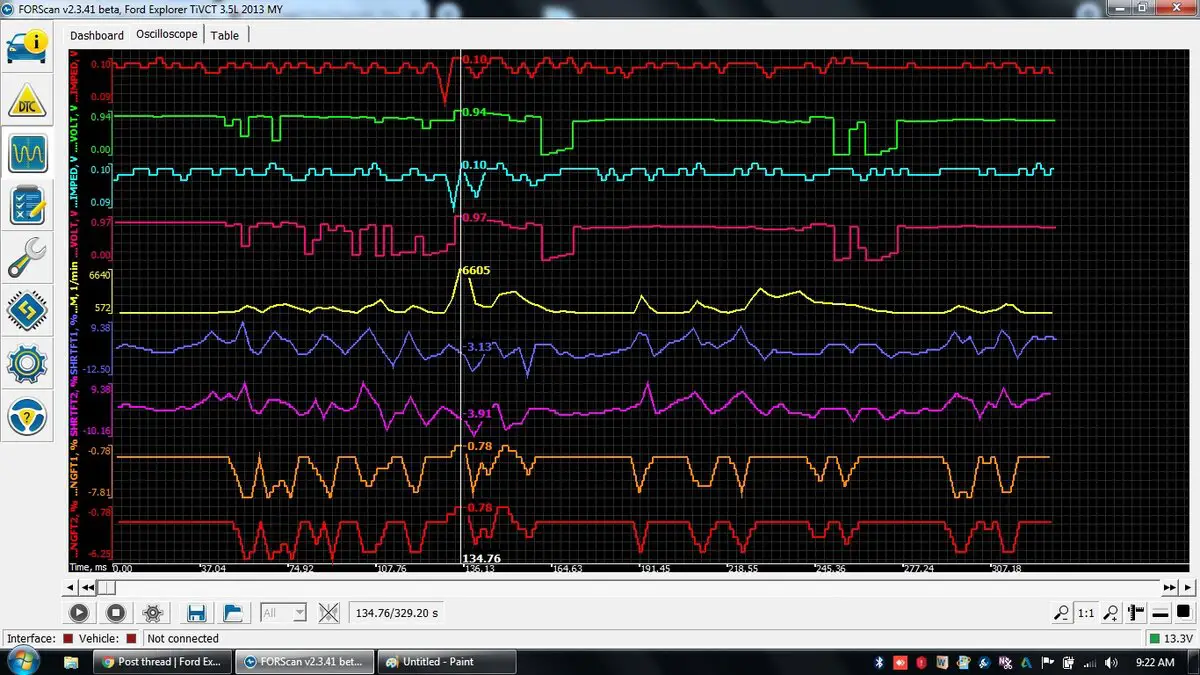

i keep getting p0420 and p0430 code. can anyone guide to pin point exactly what and where to check.
did some quick scanning , attached screenshot from FORScan.
The codes read as follows:
P0430: Catalyst System Efficiency → Below Threshold → Bank 2
P0420: Catalyst System Efficiency – Below Threshold
It seems your bank 2 catalyst is the problem. Before replacing it you could try a catalyst cleaner like cataclean. You could also run a couple of tanks of premium gas, it would be ideal to drive in the highway/freeway. A road trip would be ideal.
