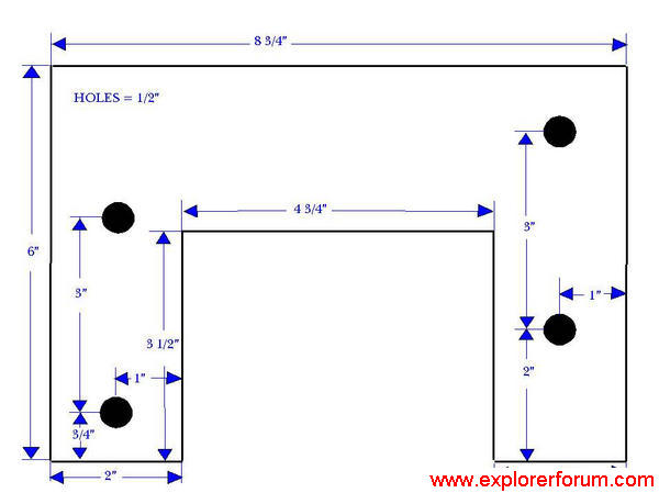

Remember that you will need to fabricate your own bumper brackets. The brackets supplied with that kit are designed for Ranger bumpers and will not work with the Explorer bumpers.
Front:
Rear:
