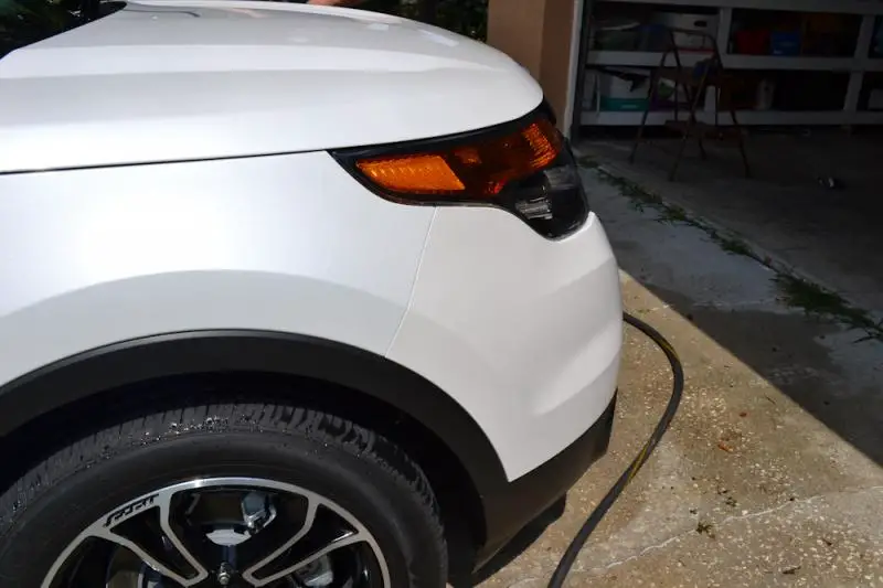

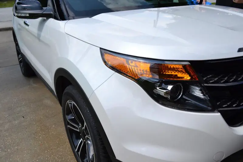

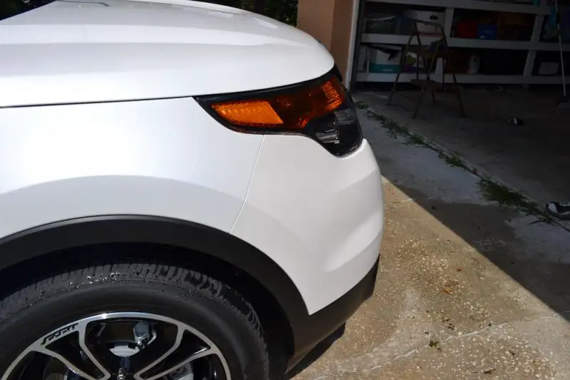

Obviously I started this post originally, I found many other vehicles that the color matched perfect, even with the same type of metallic white on other brands such as toyota, so I know its possible. However, despite my gripes about it, I was told its normal and nothing would be done about it....so good luck......I was told to look at it at a different angle and under different light.....it was like.....look, if you stand back 500 feet and look at it at a 185 degree angle, the paint matches
This is a normal condition on a new vehicle - the paint on plastic will not match the paint on the sheet metal. It adheres differently.
The cracking someone else mentioned is probably related to flex additive used in the painting of plastic parts, usually bumper covers. There is always the chance that this could happen whether it is a re-paint or not.
It is difficult to tell from your pics as to whether yours is in the normal range or not. Best of luck and keep us posted on how you make out.

This is absolutely correct. Metallic and Pearl paints especially silvers, golds and pearl whites will not match 100%. If you look at these cars and they have plastic handles, moldings, bumpers and so on they will be slightly off. I have worked at a collision repair shop for 12 years and when customers come in I always point out the mismatch before we do any paint work. most people never realized. if i didn't tell them up front they would assume we painted it the wrong color.
I have the platinum and there is a slight difference in colour betweent he bumpers and the vehicle. I must say the pics you posted look worse then mine do. I had to stare at it for awhile before i noticed mine. Also the gas cap cover..i figured it was different materials having a slight colour difference. Mine is barely noticeable now but i wonder over time if one material will fade quicker than another and it becoming more noticeable.
I wish I could show you all in person. I cant believe I didnt catch it earlier, but we picked the car up and night and as I said, my wife drives it most of the time. I hope the dealer can make it right. I cannot look at the front end without noticing the yellow bumper. If the difference was very very minimal difference that you could only tell in certain conditions then I wouldn't care, at this point its just a straight up different color and shade. It can be seen in dim light or direct sunlight. I hope they can fix it correctly. Maybe I should have just bought black!!!

Just a quick follow up.
I drove down on Monday and dropped off the vehicle. Dealership agreed to repaint the front and rear bumpers (rear was off almost the same as the front) and fix the few other things I had issues with. He agreed that the paint was more off than he expected and showed me a few other brand new vehicles on the lot that had this flaw. Most of them were not as bad as mine. He and I agreed that we think the dealership paints the body separate of the bumpers and then they are put together. Certainly not a good way to do it especially with metallic paint. I should get to pick her up tomorrow or Friday. I hope they do a great job matching the paint. I will let you know how things go!
