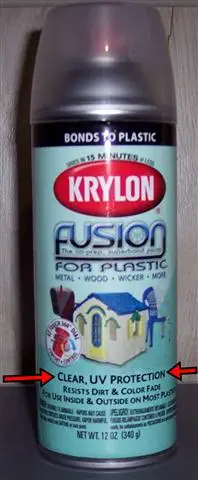

Mine are currently faded. I would normally hit them with wax every time I washed my Ex, but I haven't washed it in a while. I plan on sanding them down and spraying a couple of coats of Fusion Clear Coat on them to help protect against the sun.

I plan on doing this soon. So sand with 600 grit....... use Krylon Fusion gloss black...then the clear coat.

Use clear on the pillars or the paint will fade. Sand with 600 grit, wet sand with 800 grit, spray with krylon fusion black, then spray the clear after the color has dried.
