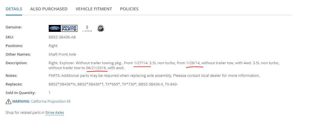

As some of you may know, Ford sometimes updates their parts and the ending titles for the part numbers also becomes different.
I just went to the local dealership to replace front right CV axle, according to my vin I needed BB5Z-3B436-N but seems like it was replaced with BB5Z-3B436-X.
While trying to replace the part, they noticed that the one with the X was not fit properly.
Has anyone experienced something similar to the same or other parts? If so, what was the part number that worked for your vehicle?
bb5z-3b436-x or bb5z-3b436-AB seems to be the proper ones but non of those are fit for the models that are built during or before 2012

I don't know why your last statement is a concern since you have a 2013 Limited. BB5Z-3B436-AB fits a 2013 Explorer.
My 2013 limited was built in 2012. Yes, in theory BB5Z-3B436-AB should fit, but it does not.
If you can read the description on the link you just posted, it also mentions From 1/27/14
Suggest to your dealer that they call the help hotline in Detroit.
There were multiple possibilities based on engine, towing option, and production date and someone is going to need to sort it all out.
