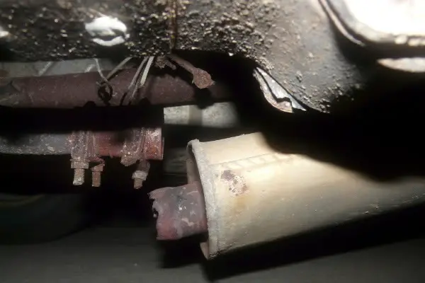

In the mean time, I read your post while I was at work, went outside on a break and noticed this.....
LOL, so I'm in your boat on this one, gonna have to get that fixed soon I guess ><
I would say it's hard to get the timing off on these things, but I'll let someone who knows more about how the timing works on these 4.0L's chime in on that one.
I'm glad I dont live in a rust state. :p:
I don't either! But the truck did most of it's life, Virgina in fact..... This tuck has more rust underneath and in the engine bay then steel anymore. ><, As time goes on I'm going to be fixing that! LOL
