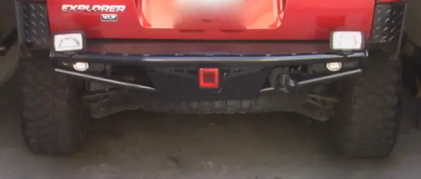

Mine are wired in pairs of 2. 1 pair per switch and relay. roof lights are set up outside 2 inside2, set at around 50 and 100ft in front of me. fogs are on a switch and the lower off roads are on a switch.
This gives the most choices of what lights to run and when i want them to. Some guys wire the aux lights to come on when the high beams are on but in heavy snow fall, high beams are not the best time to be used, low beam with your lower aux set up for your road or trail edges would be better. Also when wheeling at night, with a couple trucks you might need the aux light to show the trail, but do not want to blind the guy ahead of you.
Looks like they belong there.
