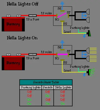

This is my first foray into installing lights on a car, and everything seemed to be going nicely until I actually tried lighting them up at the end. I think the problem originates at the switch, but I'm not sure. I used this diagram for my install with the exception of drawing power for my switch from the auxiliary power socket instead of the parking lights:
I used a multimeter to test the power at the switch and the power at the relay, and I've got 12 volts at both, but when I flip the switch to the on position, I'm not reading any power at the load prong. Should I have a reading there when it is switched on? The switch lights up when it is turned on, but the lights don't come on. If anyone has any thoughts on what the problem could be I would appreciate it. Like I said, this is my first time doing this kind of work, and I may be overlooking something.
