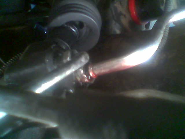

Check valve huh?? When i compared the old and new racks the were 100% identical so im hoping i didnt miss anything lol. As far as the lines go im assuming the inlet from the pump goes in the top fitting and the return line through the cooler is the bottom fitting?
Here are the pics, it seems to be leaking now so im gonna go back out and try to see from where.

After reading a few other threads and looking at some pictures it looks like i might have the lines reversed. Which line goes where?? On mine i have the top fitting hooked up to the power steering line and the bottom fitting if hooked up to the cooler.
...izwack knows alot about steering...;)
