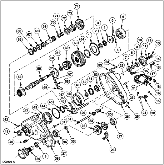

GJarrett hey if you find a way to turn off the all-wheel drive just remeber the front drive line is still going to be spinning all the time with are front ends just like mine does and I am not sure but the centrifugal clutch and some other fun stuff will still be spining. We should use the chat room some night and brain storm. I hope this helps us.
