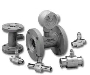

The way I see it, it is just speculation unless you have a reliable source for info (most of the info in the service manual seems reliable) or you perform a test to determine the value yourself. Anyone volunteer to check the flow rate by removing the cooler line and seeing how much ATF flows at wide open throttle?:D
If you really need to know this, you could put a rotary flowmeter in the cooler line, but I haven't done it and I don't need to know bad enough to think about trying it.
I could sell you one
I think the one in the center of the picture would be adequate :D
Ya sure? That is only a 2" (1.6 - 160 GPM). We go all the way up to 12" which would cover your from 150 - 15000 GPM. Of course you would have to have a very secure since it weighs about 400 lbs. :)
Hmmmmmm.......I got one
Just the right size, 3/8. When I get the 92 back together, I'll try it. Have to do some plumbing anyway to hook up the remote filter. Don't you just love science.
