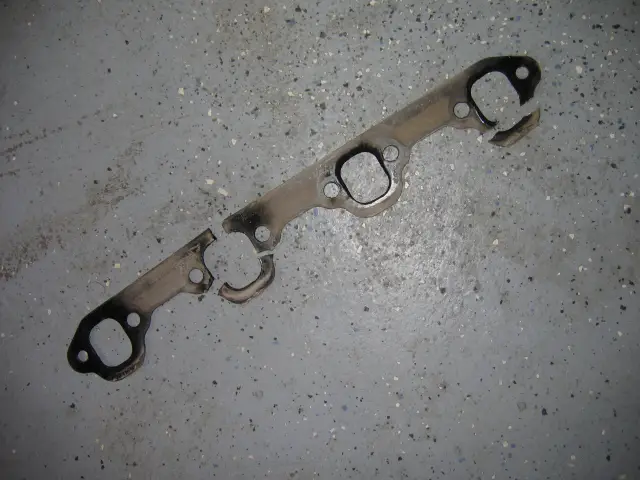

My TM gaskets cracked just like 410's picture- they got very brittle, crumbled when they came out.
