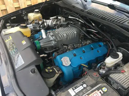

I like to like I got pretty close to that with my “Explobra” build from a few years ago. I am changing superchargers soon and I’ll hopefully be around 550 hp. Still AWD also.

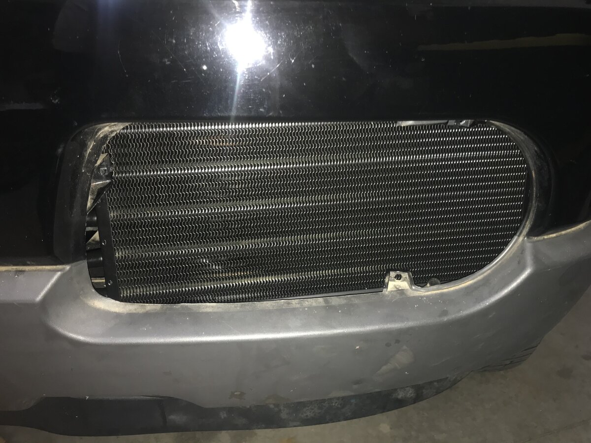

But todays development, I finally figured out what to do about my oil/trans cooler situation.
Since I went to an aftermarket radiator, the stock cooler has just been ziptied to the aftermarket cooler (which is basically under the crank pulley, with the fan blowing up).

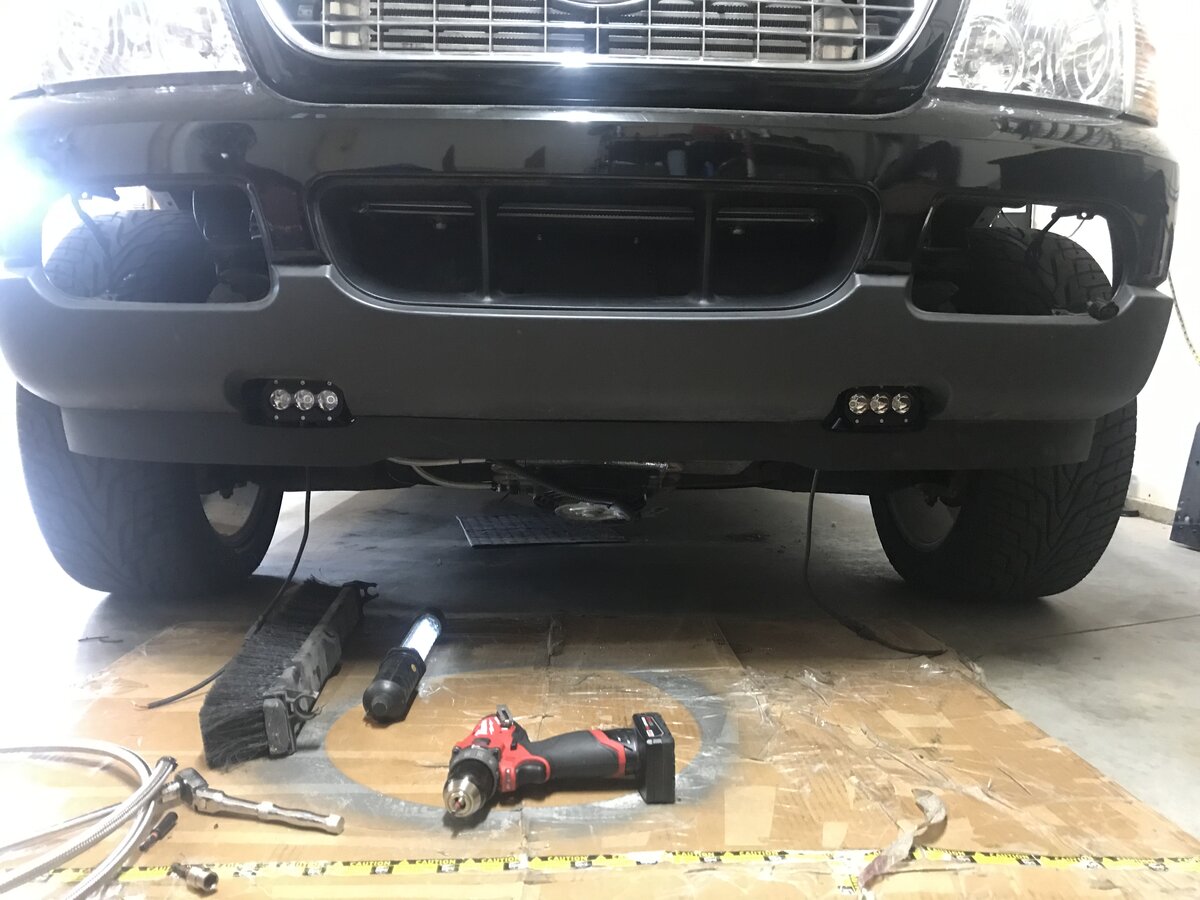

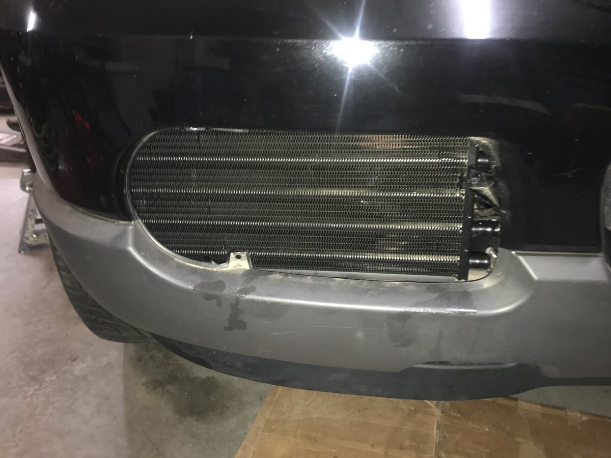

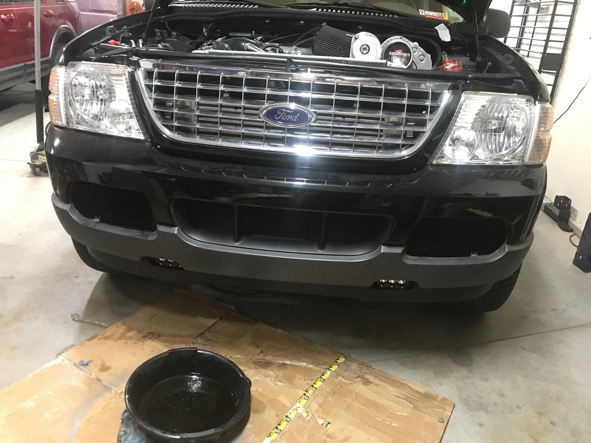

What I decided to go with is a pair of 7x12" coolers. Passenger side will be a transmission cooler (with the fanned cooler inline behind it), and then I'll put a matching cooler in the driver's side for engine oil. Bye bye stock fog light buckets. I had plans to duct the fog locations for fresh air in the engine bay but I think I like this idea better. Not sure how much, if any of the fender liner is going to go back in the truck at this point. I've got a lot of plumbing and electrical running through the wheels wells already and this isn't going to make it "more factory" in there. haha
Prepped for coolers and installed the new “fog lights”.

I gotta say... sticking with my “mostly stock look” theme I’m super happy with this. You have to know what you’re looking for to catch it.

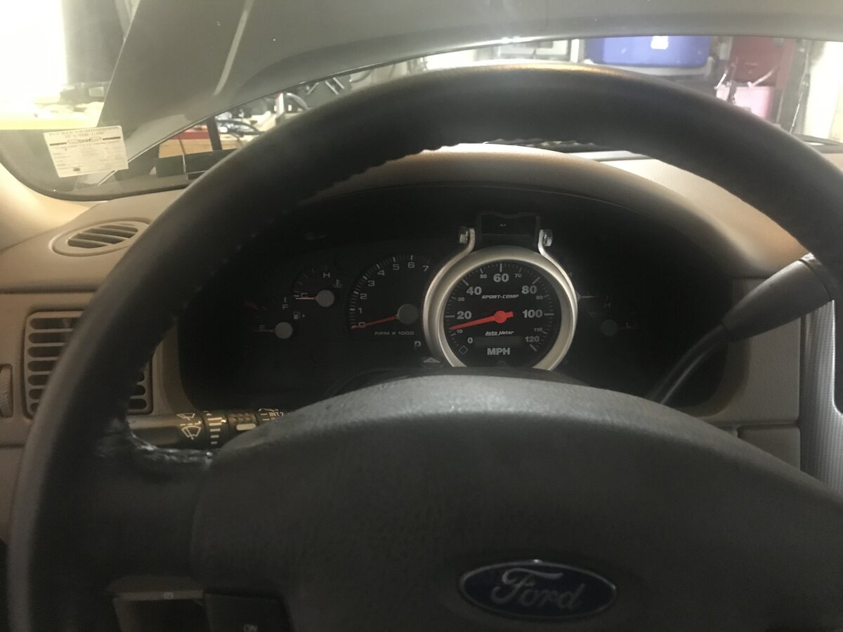

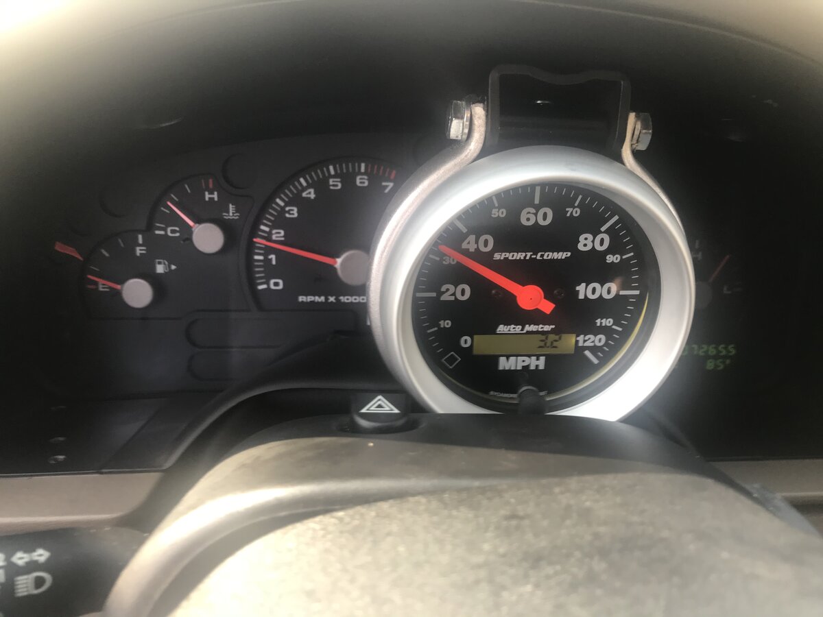

I finally have a speedo/odo!!
