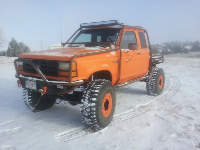

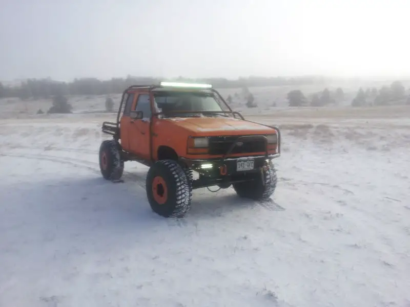

Daylight pics...

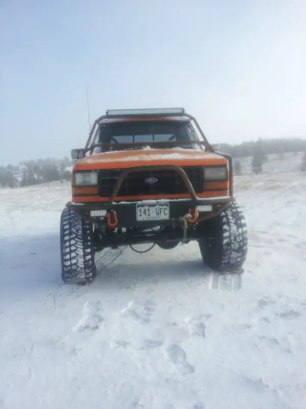

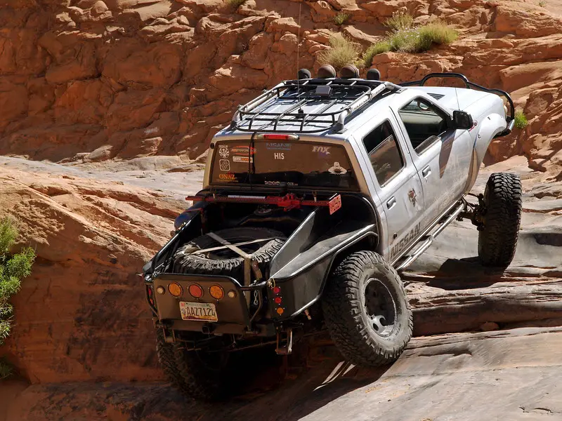

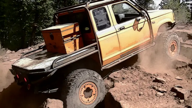

I think Double R is missing a fender bar???

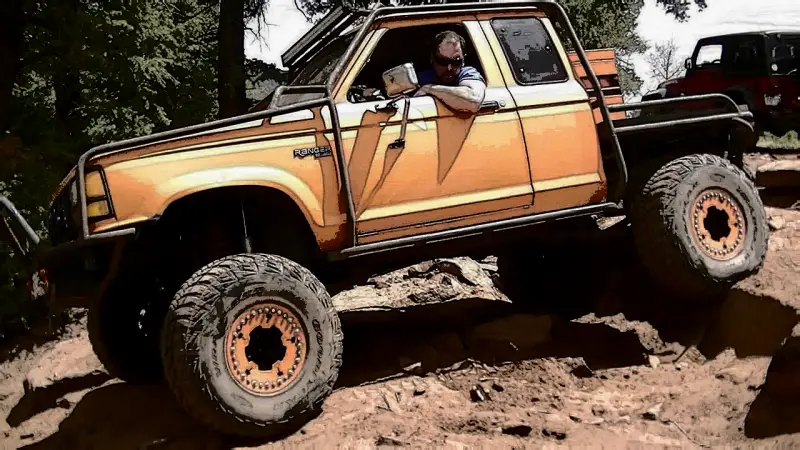

LOL. Which size tube do you use on your exo's, bumper's and slider's? I plan on doing a full exo on my Trac after I do my SAS. My bed will eventually come off as well because it's fiberglass. Gonna build something similair to this...
Sorry, not trying to hijack, just needing some advice from the expert on the subject.
The bed, front bumper, and bed roll bar are 1.75 .120" wall HREW. The cab part is 1.5" .120" wall DOM. I still have more tube to add to cab when I have time. Once the weather breaks and days get longer I will be more motivated. Need to finish up the Aviator too. Plus I got mods coming to the Merc. And I almost have all the parts for a new build I am working on. Oh and I have 2wd SAS coming up too. It was a high of 14 today so I didn't get much done. LOL

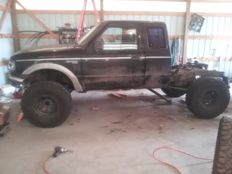

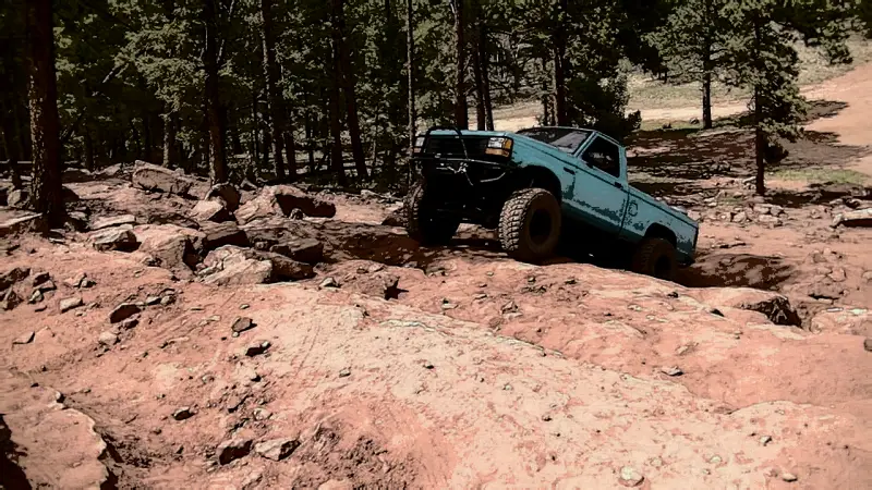

On another note I got Lazyboy flexing like a beast!

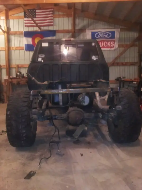

Damn thats a sweet Aviator. BTW was it a pain to covert those style chassis? I was talking to a co-worker about your Aviator. Wanting to do it to a 4.6 explorer.
It wasn't bad. just have to lift them a ton to clear everything. Hardest part was the steering box. It was worse then the Merc. Which I thought sucked. lol

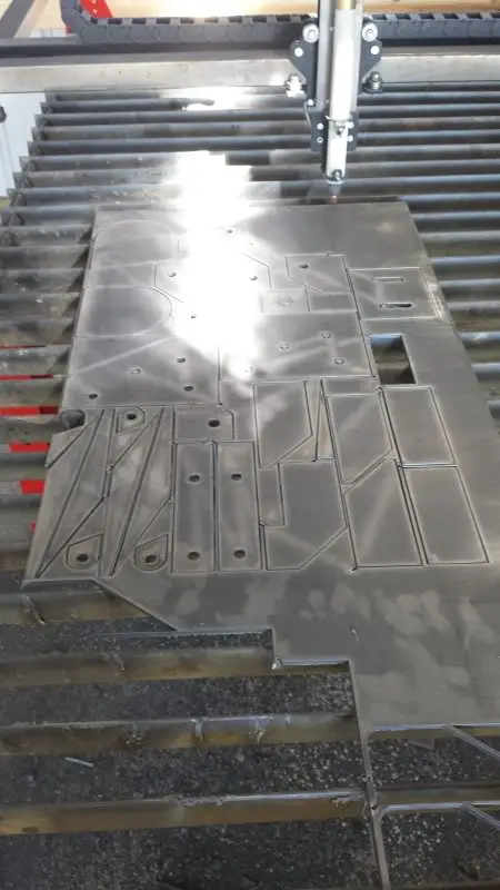

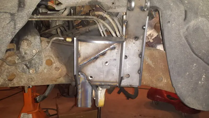

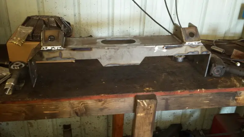

Almost done! Designing a bolt in SAS kit for RBV TTB...
CNC working it's magic!

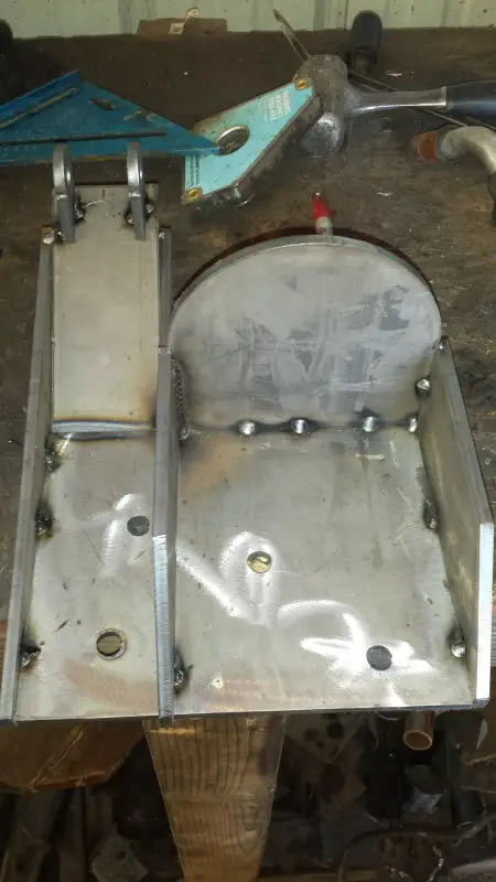

Bolt in HD Crossmember with link mounts...
Bolt or weld in Pass side coil bucket with long travel shock mount...
