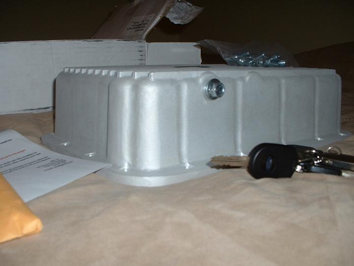

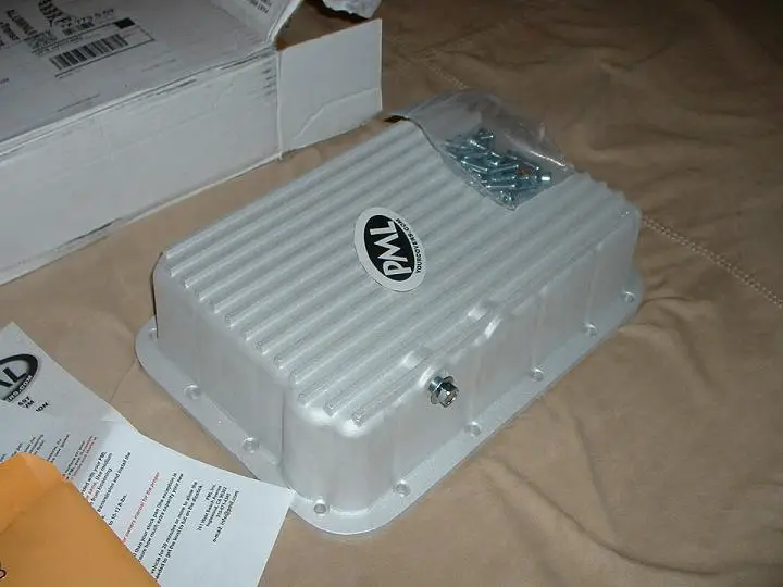

The tranny pan is in.
That is one deep pan.
So the 5r55e has the same transmission pan bolt pattern as the 4R70W? An is considered an AODE transmission?
4R55E, 5R55E, 4R44E, A4LD - (says it fit's all of these) It holds three more quarts than stock.
You would be surprised how beefy this thing is. It's super strong and probably weighs 5 pounds are more.
I guess I can say I have a bullet proof tranny pan now?
Jake, I'm sorry man, I don't know what link I clicked on but I could not find a pan that stated it would fit the 5r55e, I was being dumb or something. I see where ya got the pan from now. I just did a search for PML and got the yourcovers site and found the pan ya got, sorry once more about that.
I didn't know there was a difference in filters between the 2wd and 4wd, guess the 2wd filter is shallower?
The 4X4 looks the same except it has a big tube like pc on the bottom to get to the oil.
