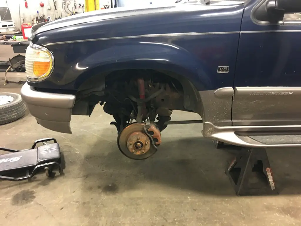

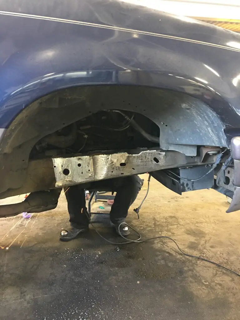

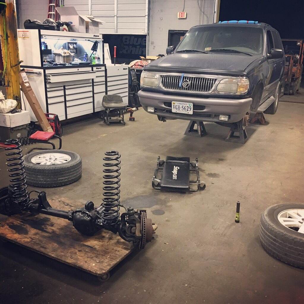

Picked up a 1997 Murcury Mountaineer 5.0L/Awd for $500.
Decided to do a sas conversation to get a larger tire under it and because I just can't leave anything stock. I don't plan on wheeling or off-roading at all. To save some people the hassle or to prevent an unpleasant reply, I could care less about the opinion of people that don't approve or that would do things differently. I'm posting for those who can benefit from my build.

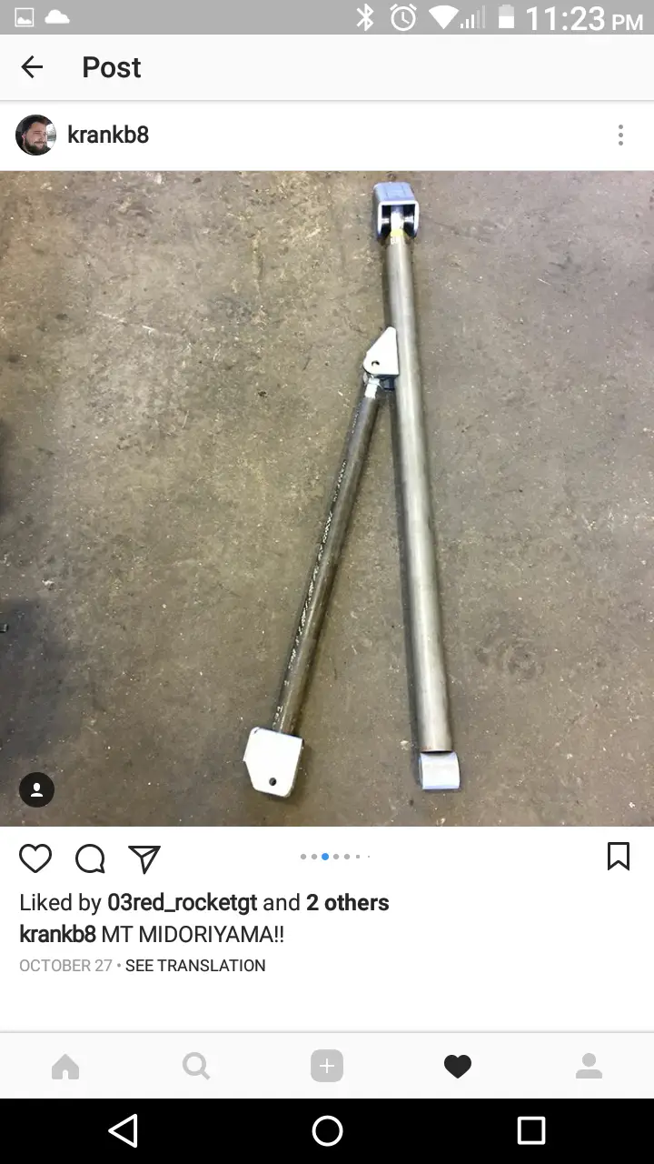

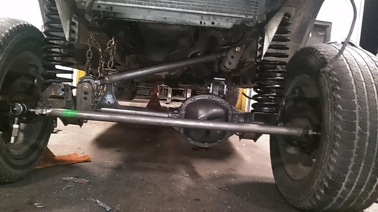

Build parts list so far,
Front:
Dana 30 out of Jeep Cherokee
Ruffstuff DYI long arm kit
Ruffstuff Ylink steering kit
Ruffstuff Pan hard kit
Rusty's offroad 5.5 XJ springs
James Dunn Ford Bronco coil buckets
Custom mounts/brackets
